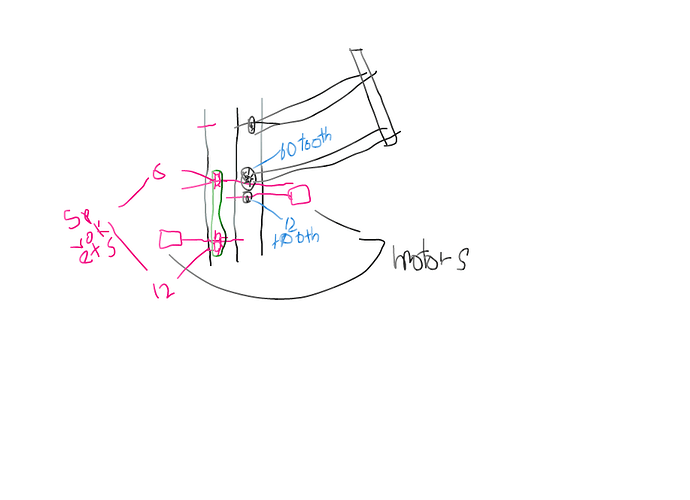

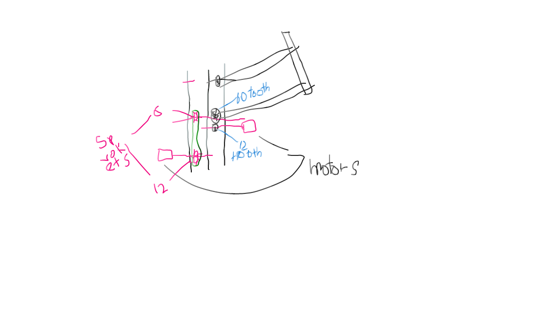

to which gear should i connect my c channel to 1:3 or 1:5
because i have a 6 bar, should have one of the gears, connectd to the 1:5 and have another gear on top for the other ch channel
it will look something like this,
and can this be done wit speed motors
both
You would connect your c channel to the 60 tooth gear (1:5 gear ratio).
You would not connect the other bar in your six bar to a gear (just have it on an axle or screw).
If you used the 1:15 external gear ratio (1:3 and 1:5), you would use turbo motors.

but if i used the 1:10 gear ratio, would t look something like this
edit - my lift has 4 motors total
