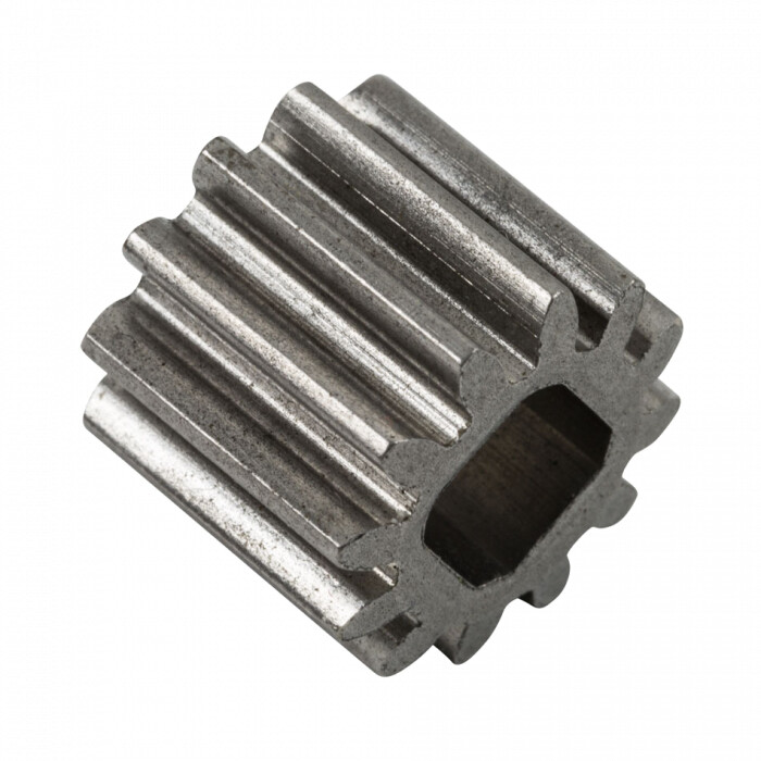

My team is building a mobile goal lift on the rear of our robot, pretty standard, picks the mogo up with two pieces of c channel and tilts it back into our robot. However, we are struggling to generate the necessary torque. We have two green cartridge motors (no red ones remaining), and a 2.33:1 ratio. Originally opted to not go to 7:1 because the metal gears we have dont fit on our high strength axles (i guess they changed at some point?). Is the better solution to file the edges of the high strength axles so the gears fit or seek out high strength cartridges? My other question is, for teams that have a similar lift, do you use a hold command to keep the mobile goal up when not moving the motor actively? and if you do, do you find it overheats motors?

They sell pinions that accept high strength shafts

Thanks for the info on the details of the hold command. As for the gears, we have them. However, for some reason, our high strength axles don’t fit in them. I was talking to our mentor and he said that one of the other teams had to file the corners a bit so they could fit in those gears. Not sure if we just have really old gears (some of these parts are a decade old i believe) and they’ve changed the dimensions, but this wasn’t a viable solution without some alteration to the axle. What makes it more weird is that the same axles do work with high strength gears of larger sizes. Also, what is so undesirable about a compound ratio?
