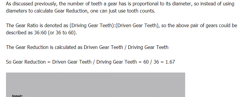

So recently a topic has come up on our robot reveal post on Instagram about the way gear ratios are written. It seems that another user thinks that we are writing them the wrong way around, and have sources to back that up. However, we also have sources to back up how we are writing them.
If we have a 12 tooth gear (powered by a motor) turning an 84 tooth gear, we would write that as 1:7 (a gear ratio for higher torque). However, this user is of the opinion that this should be written as 7:1 (The user agrees that this is for torque, but thinks it should be written like this).
Similarly, if we were to have a 60 tooth gear (powered by a motor) turning a 36 tooth gear, we would write that as 5:3 (A ratio for speed). This person would write it as 3:5.
My source is the VEX Robotics curriculum website, which states:
The full web page can be found here:
However, the other person’s source is PLTW Principles of Engineering, which states:
My question is, which is correct, and why are there these inconsistencies between two sources?

As long as the math is correct at the end, you did it right! If you are computing angular velocities of the shafts, slower is less than one, faster is a ratio more than one. And if you are doing torque calculations, more power is a ratio more than one, less torque for greater speed is a ratio less than one.

@jonathans your expression of ‘gear ratio’ is correct. The term ‘gear ratio’ does have a clear definition, its just that the term is commonly misused. (At least, to my knowledge)
According to the SAE and numerous other sources…
That quote can be found on this PDF from the SAE, page 3 line 2

@Amadeus Funny you use that document. I am using the same one as one of my documents of support. However, the VEX page referenced by the OP is just the opposite…and he is quoting that.
So, is the consensus that (in the example from OP) that VEX is using confused terminology in its EDR Curriculum?
@jonathans
Well. according to The SAE, US Bureau of Transport, MIT, Carnegie, NYU, Brooklyn College, and a whole list of other reputable sources, (just google search “gear ratio site:.edu” and .gov) yes apparently the VEX curriculum got ‘gear ratio’ backwards.
@5YNAP5E That is my thought as well, but I wanted to get some feedback. Thanks for your input. It was a great help.

I emailed VEX support the other day to get to the bottom of this on their end concerning the referenced lesson in the EDR curriculum. Below is their response…looks like we (@callen, @5NAP5E, @tabor473).
Thank you for the email.
I have asked one of our Engineers and he said that you are correct! Most books on Gear Ratio have it reversed vs what the
EDR curriculum says. Thanks for bringing it to our attention.
I assume this means they will correct their curriculum content…waiting to confirm that.
