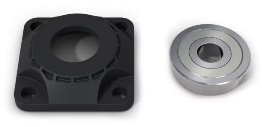

As someone who has also had to solve a similar problem recentley, I found these bearngs to be extremeley helpfull, as they reduce friction by quite a lot, and have 4 points of contact rather than two
so that the shaft is less likley to wander within the hole since there are more points of contact than a traditional bearing flat.
These are also excellent because occasionally you may need to install a high strength shaft in the middle of 4 holes such as if you want to mesh a 12 and 48 tooth gear on a 5x C channel, and these bearing mounts can actually be fitted diagonally with just two holes to act as a bearing flat even though you only needed to drill one custom hole, rather than the three needed to install a bearing flat in a custom hole. This does stretch the part a little, however, which can cause cracking if not screwed in correctley.
I hope that helps!
