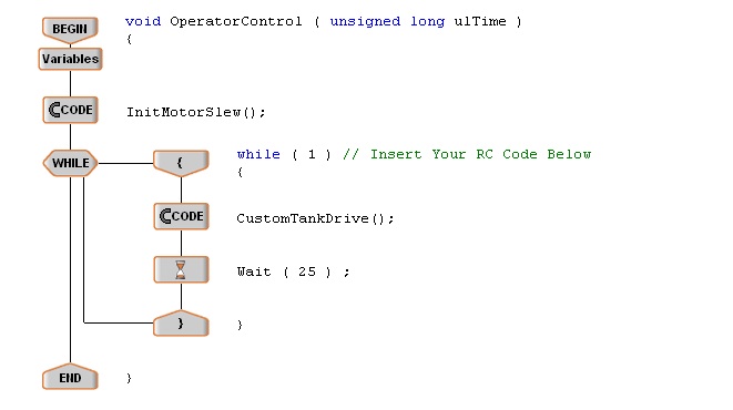

You would call this from operator control as follows.
https://vexforum.com/attachment.php?attachmentid=5299&stc=1&d=1328853616

Hey jpearman,
I was trying this code out to see if it will help in our chain driven drive which causes sometimes slippage when the drives yanks it from full forward to full reverse.
I put the code in an when I run it I get no errors but I cannot drive the motors. The motors I’m trying to drive are ports 4 and 8 on the left side of the tank and 5 and 9 on the right side of the tank.
So based on that I’m using your code with my drive numbers, right?
SetMotorSlewed ( 4 , joyCh3 ) ;
SetMotorSlewed ( 8 , joyCh3 ) ;
SetMotorSlewed ( 5 , joyCh2 ) ;
SetMotorSlewed ( 9 , joyCh2 ) ;
I’m getting values from the joystick because I’m dumping those to the LCD - so the values change as I move the joystick but no output to the drives.
Any ideas on what I might be doing wrong here? I didn’t change any of the other lines of code, but perhaps I should?
I’m calling CustomTankDrive ( ) and I know it gets that far because thats where the code is I’m getting the values from the joystick and writing them to the LCD.
That function calls SetMotorSlewed ( ) but then I’m having trouble following the program logic after that. I cannot see how the other functions get called from there?
Any ideas would be most helpful! Thanks!
Did you initialize correctly by calling InitMotorSlew() at the top of operator control ?
Doh! No, I didn’t… feeling a little sheepish now… thank you so much. Working now - on to further development!

    // Set drive
    drive_l_motor = (forward + turn);
    drive_r_motor = (forward - turn);
    // normalize drive so max is 127 if any drive is over 127
    int max = Abs(drive_l_motor);
    if (Abs(drive_r_motor)  > max)
        max = Abs(drive_r_motor);
    if (max>127) {
        drive_l_motor = 127 * drive_l_motor / max;
        drive_r_motor = 127 * drive_r_motor / max;
    // Invert if necessary
    if( ucLeftInvert )
        drive_l_motor = -drive_l_motor;
    if( ucRightInvert )
        drive_r_motor = -drive_r_motor;
    // set motors
    SetMotorSlewed ( ucLeftMotor ,  drive_l_motor );
    SetMotorSlewed ( ucRightMotor , drive_r_motor );
