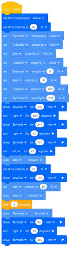

NOANKITH AUTON (2).iqblocks (11.3 KB)
Here is the code,

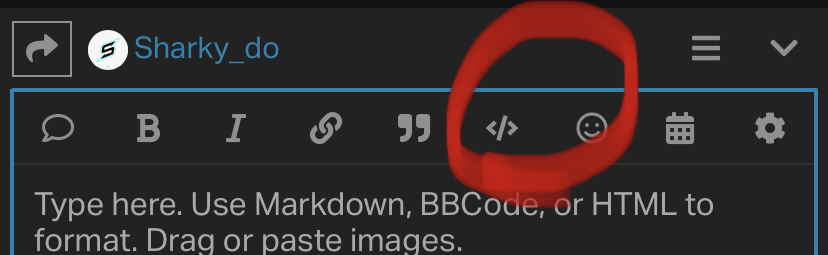

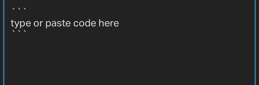

No need to make us download your code, you may just press this button:
and it’ll ask you paste to paste it here
Or if you use blocks, you may just put a picture of your code into this thread
I converted it to blocks and uploaded it.
The drivetrain class is very generic, it works “ok” with simple trainer robots, but will struggle with larger and more complex competition robots that may also have gearing on their drive to make them faster. You can try slowing down the turns using setTurnVelocity, but that’s about all you can do without writing your own turning code.
