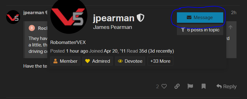

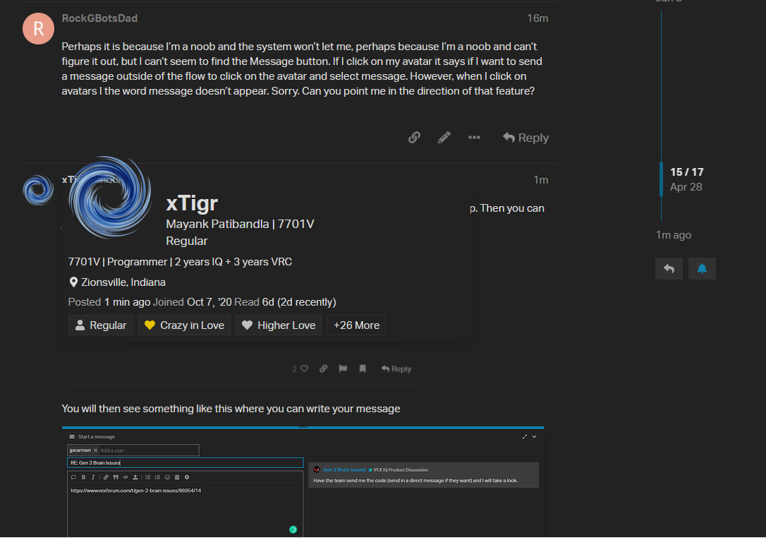

Perhaps it is because I’m a noob and the system won’t let me, perhaps because I’m a noob and can’t figure it out, but I can’t seem to find the Message button. If I click on my avatar it says if I want to send a message outside of the flow to click on the avatar and select message. However, when I click on avatars I the word message doesn’t appear. Sorry. Can you point me in the direction of that feature?
You can just click on the username or profile picture and a window like this will come up. Then you can just press the blue message button.

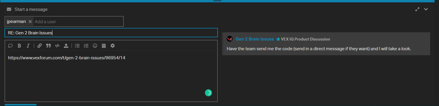

You will then see something like this where you can write your message
Unfortunately, that button is not appearing. But this does help me confirm that it isn’t there!
Try again, it’s probably because you just joined the forum, I bumped your trust level up.
