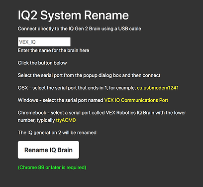

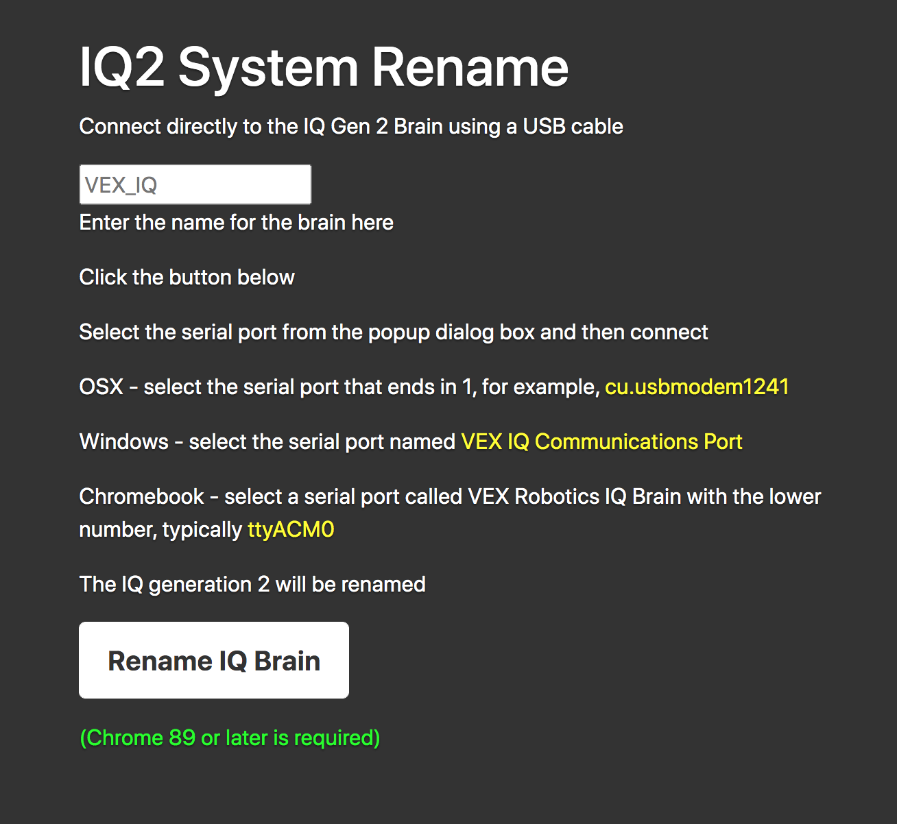

If you have access to a PC or Mac, I put up a temporary web site here that will allow IQ gen 2 renaming.
Chrome is required (or potentially recent versions of Edge on PC)
If using a PC you would need the IQ2 serial drivers installed, so you would to install VEXcode to do that. No drivers needed on Chromebook or Mac.
You will see this web page.
type a new name in the white box, connect the brain using a USB cable, turn it on and then select the rename IQ button, you should see something along the lines of this.
select the serial port as instructed and click connect, the brain should be renamed.
Check on the brain system info screen.
