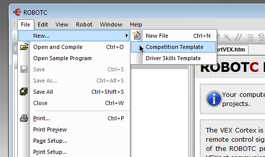

Work your way through the many tutorials on the ROBOTC web site, it will explain much of what you need to know. Here is the very short version of how to setup code for competition.
Create a new competition template using this menu…
https://vexforum.com/attachment.php?attachmentid=5302&stc=1&d=1328906623
It will present you with this code (more or less, I deleted a few comments to make it smaller to post).

Place you autonomous and driver control where I highlighted comments in red. Use motor and sensors setup in the usual way to define which ports you are using. You can simulate the competition switch using the “comp switch” debug window or use this.
Without a competition switch (or the simulation) connected then only the driver code will run.
