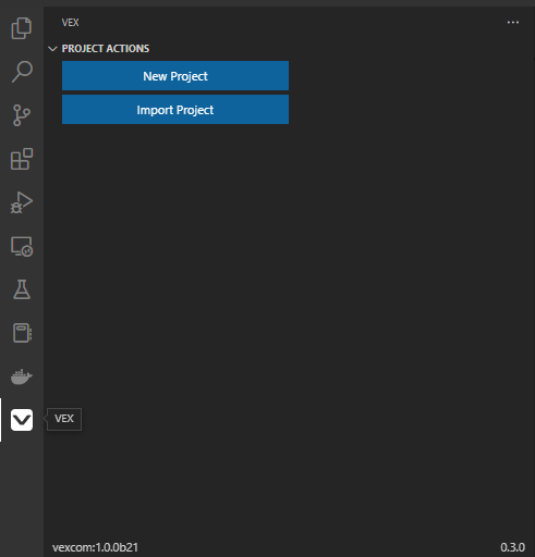

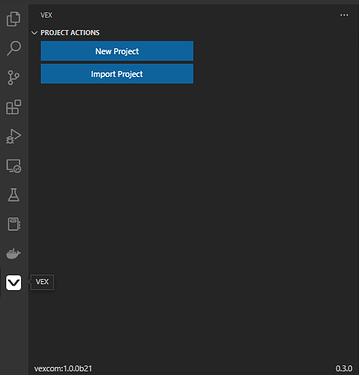

  • What version of the VEX Extension do you have installed?
    You can find this by clicking on the VEX Extension icon in the sidebar and then looking at the version listed in the bottom right corner of the screen.

I’m running windows 11 with the V5 platform. I’m programming in C++ with the extension version 0.3.0. I had neither the brain or controller plugged in, and the update was on Copilot. There was no error message or anything, it just didn’t work. However, I am programming on a windows 10 laptop right now, and there is no problem.
