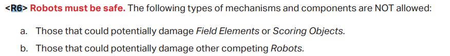

My team has been considering spray painting some of the C-Channels on our robot. One of the paints that we have considered is Rust-Oleum 301495 Specialty Glitter Spray Paint, 10.25 oz, Gold (apologies if that isn’t a link). I would like to know from anyone who has worked with glitter paint, would this would leave glitter on the field? And if so, would this be grounds for an R6a or R6b violation? I am familiar with R9a, and it does not mention anything on the topic.

R6 has to do with safety - and glitter isn’t much of a safety hazard, nor would it damage anything it falls on.
While yes R9a doesn’t specify it, (maybe G6 would apply if they’re strict), if it leaves an egregious amount of glitter on the field, although unlikely, you might get a warning to fix it.

As far as the rules I don’t think unless you were absolutely shedding glitter on the field you’ll get called. I think that you’ll be fine, it wouldn’t be a safety thing and while there are rules on debris glitter is so fine and small that I’d be surprised if you got called, that being said good job to you for being so aware bc ik a lot of teams that are far less considerate. From an EP standpoint i wouldn’t love cleaning glitter but I don’t think you’ll leave too much.
