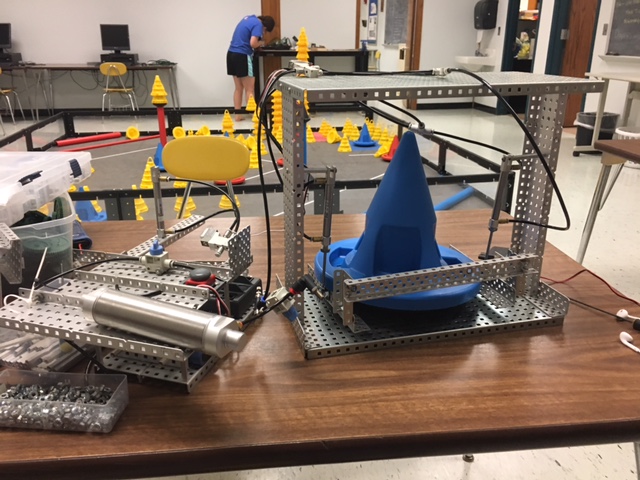

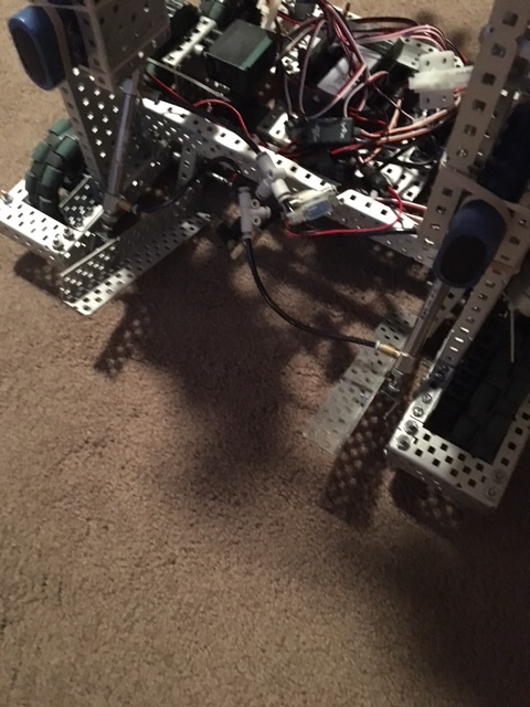

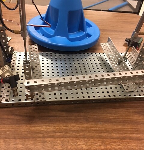

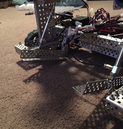

@Duke4221c thanks for all the videos. Sorry it took so long to respond our team has been offered to compete in China and so we’ve been busy building. Basically it was two L channels with wheels on the end that would fall down and we would be able to use it that way, but the only problem was that it got in the way of our claw on our reverse four bar. We have now figured out a new way by using pneumatics to hinge it. Here are some pictures of our prototype version, (which is very crude) and our first version on our robot
