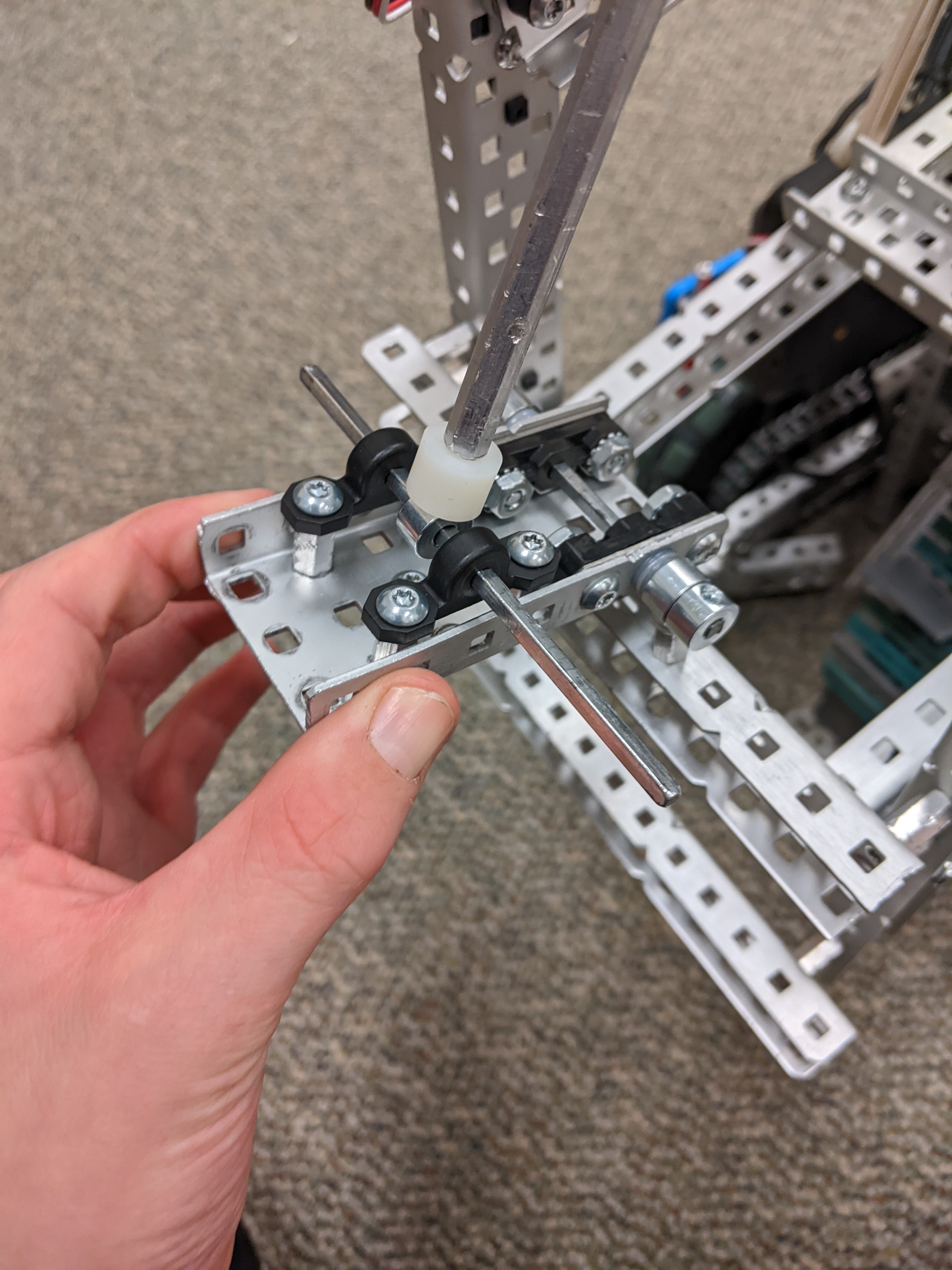

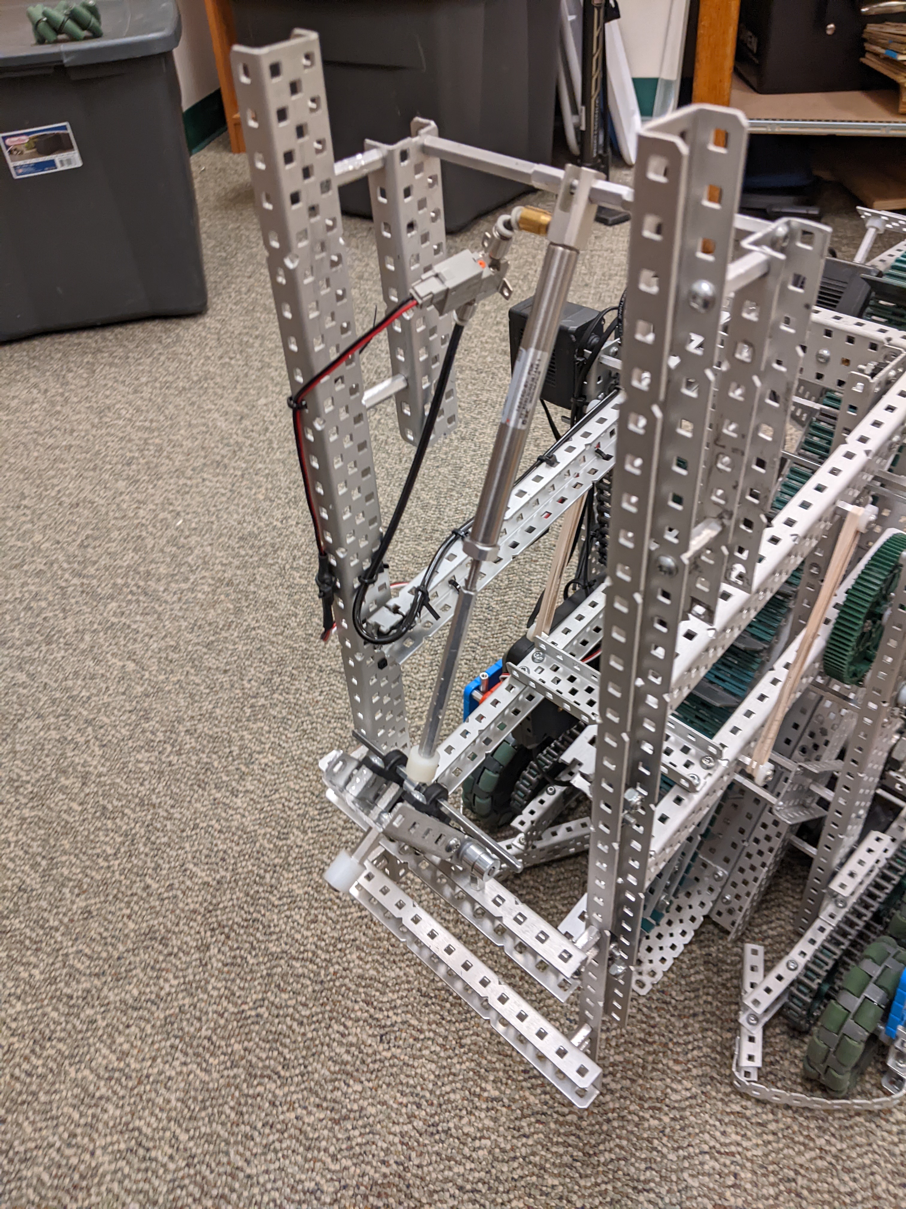

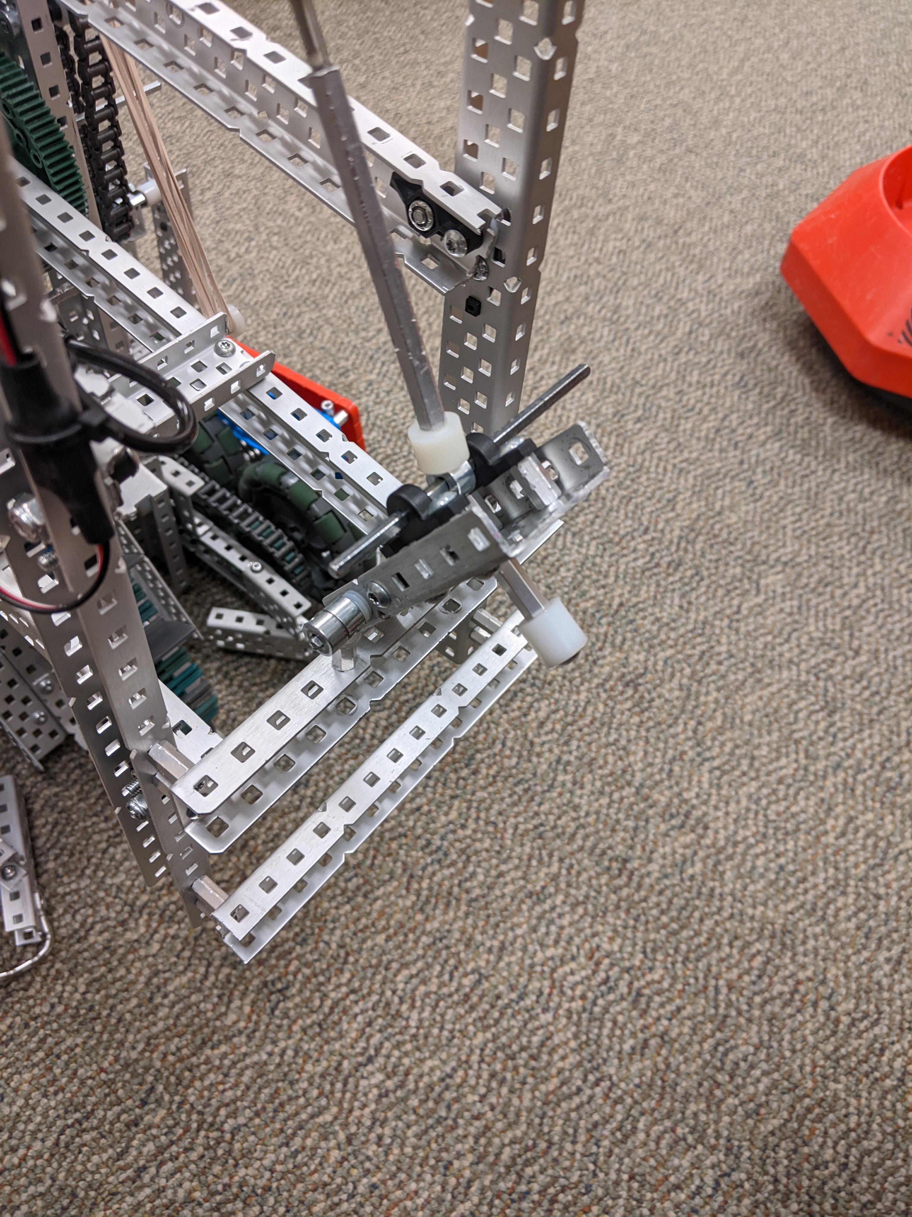

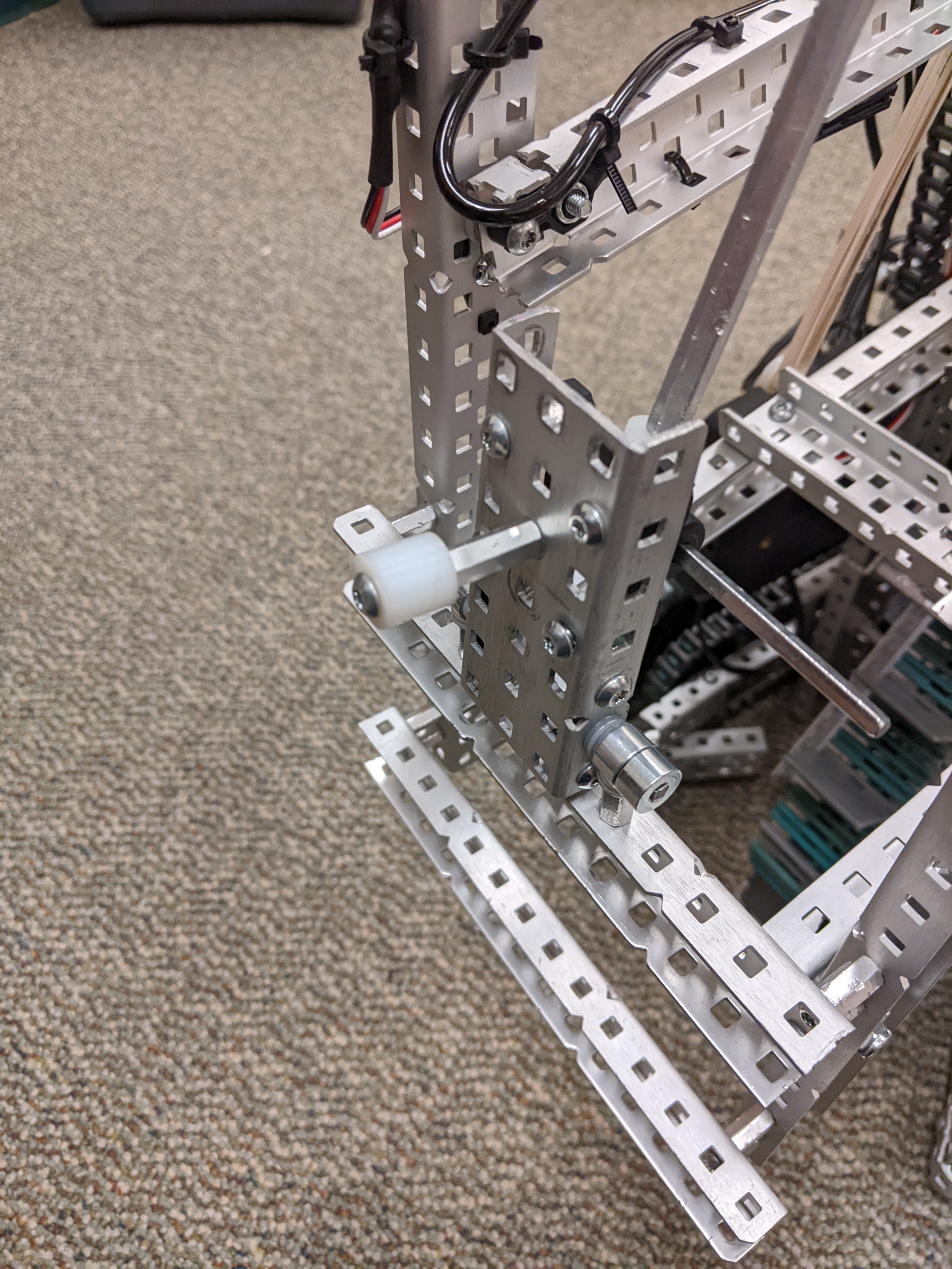

My team has a 3 wide c-channel that goes under the lip of mobile goals to grab it with a hook powered by a motor to actually grab the mobile goal (you can use pneumatics instead if you wish to). It works really well and its quite. Simple and easy to build. I’ll send a picture when I get the chance to take one.

Here is our clamp of it helps at all
We changed it a bit from when the photos were taken, we added another “tooth” and moved them from the center to the outside of the 3-Wide Channel.

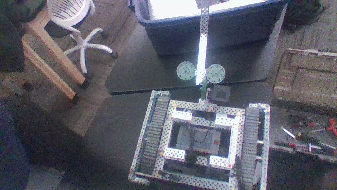

just so you guys know what im working with, I took this pic, Chromebook is tough to shoot a good pic
my friend was a nimrod to add the (you know what) on the front
Why the tank treads, and how are you going to attach the claw?
If you are using tank treads instead of wheels I wouldn’t suggest that
I’m getting flashbacks to my IQ years with the tank treads instead of wheels
I wouldn’t use tank treads if I were you, but if you absolutely insist, at least center them. All it takes is one little nudge and your treads will grab the chassis.
