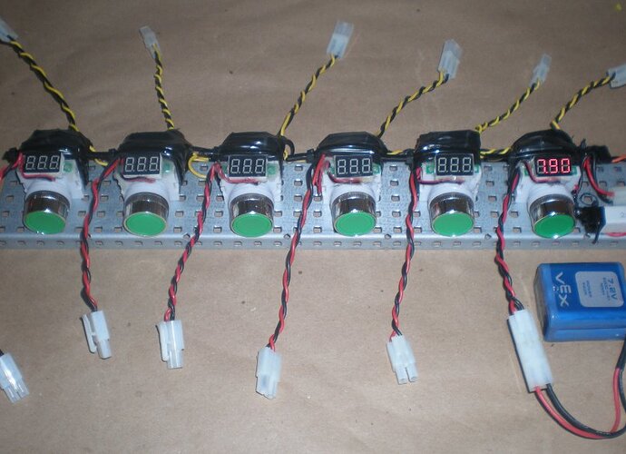

Since most of the teams intimately know each of their batteries, simulating a light cortex load of about 1.5A with a 5 ohm resistor is quite sufficient. Here is the schematic of a single channel of the six channel charging station pictured below:
You connect VEX chargers to the top (yellow) wires, then batteries to the bottom (red) wires and, by default, they charge and Mini LEDs display voltage. On each battery we write voltage when it is fully charged or discharged and this way you can estimate where you are in the charging process.
If you want to do a load test, you press the button and it disconnects battery from the charger and connects it to the tester (orange wire). In the picture it is a 5 ohm resistor, but could be a fancy tester. All six channels have common ground (G) and test (T) points connected.
Nice thing about this setup is that you could see all voltages at a glance and you don’t have to pull and reconnect batteries every time you want to test them.
I built two of these and field-tested them during several recent competitions. For whatever reason, high school teams would only use two or three channels at most. However, middle schoolers were all over it - running back to the station and pressing test buttons whenever they had a chance.
