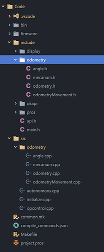

I have an API that I wrote in a PROS project. I want to share it with my sister teams. What are some good approaches to solving this issue? I know that there is manual copying, but that sounds tedious to manage between teams.
The project is hosted in a git repo, but submodules look like a headache. Plus, I have some code in the include folder and some code in the src folder
All of the stuff under the two odometry folders is mine and all of our teams need to use it.
What would be a good way to have this code exist on all of our teams’ projects while also making it easy to update the API?
