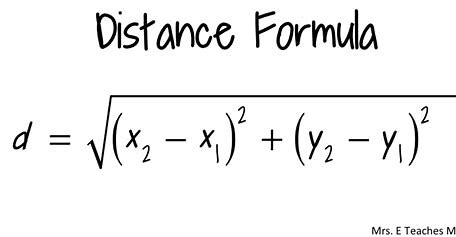

We are currently using good old distance formula
where current x is x1 and desired x is x2 and
probably not the greatest way, but is super accurate
