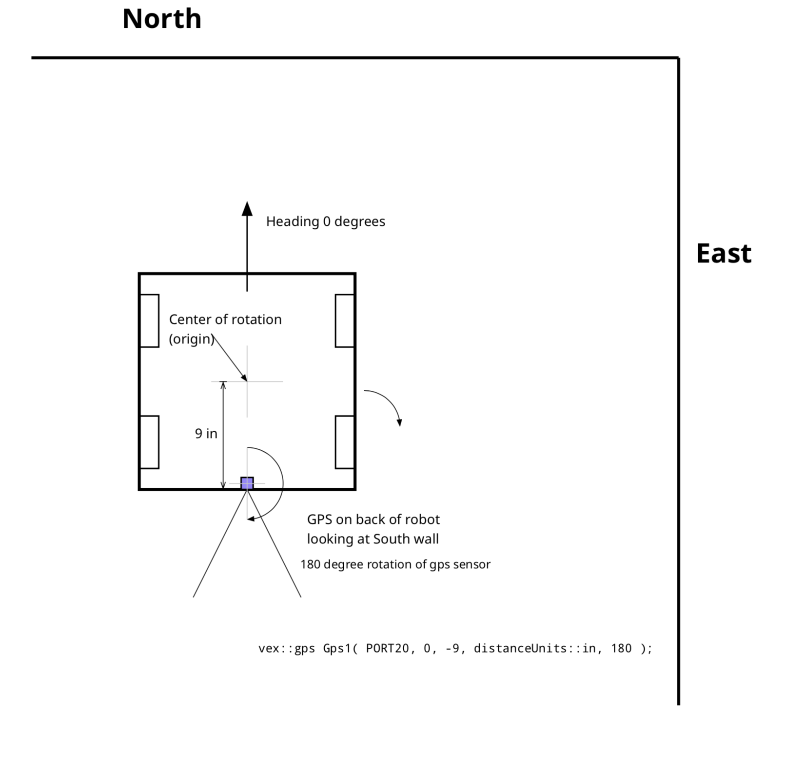

That sounds more like a configuration error, is the sensor mounted on the rear of the robot ?
https://kb.vex.com/hc/en-us/articles/360061932711-Using-the-V5-GPS-Sensor
https://kb.vex.com/hc/en-us/articles/4402678201620-Mounting-the-GPS-Field-Code-Strips

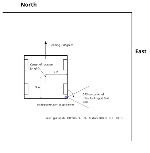

It’s mounted on the side with the setup offset = 0
If it’s on the side, angle offset should be either 90 or 270 depending on which side.
Oh I see! Thanks for the response, I just got confused setting the offset.
These may help.
