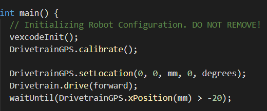

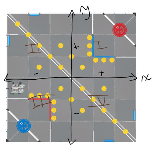

I need some help in gps sensor…in my skills when I program it to do rollers, it keeps driving forward and doesn’t stop. I debugged it and tried it from (0,0) to (0,20). It still did the same thing and kept driving forward. What should I do?
Here is my code:
For getting coordinates, these are the quadrants i’m using

(Note that it helps to include the full text of your code between two sets of three ticks ```)
Is this all of the code? I don’t see where you tell the robot to stop.
Drivetrain.stop();
oh thats just a segment of it…heres the full thing:

int main() {
  vexcodeInit();
  DrivetrainGPS.calibrate();
  DrivetrainGPS.setLocation(0, 0, mm, 0, degrees);
  Drivetrain.drive(forward);
  waitUntil(DrivetrainGPS.xPosition(mm) > -20);

I will try adding the stop… just realized i didn’t add that.
