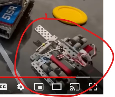

Would you please show us an clear example how to mount the odometry for us to learn or copy
Screenshot 2023-05-30 120555
because V5 website shows connecting it directly on a gear but a lot of videos have a separated odometry like below.
So you can do either way. The odometry pods offer the advantage of tracking position even if the DT slips or if you get pushed sideways ect becasue they never loose contact with the ground. IF you put them directly on the dt gears then you can cut some weight and makes robot more compact. We just used the drive train and didnt use a latteral wheel last year because we wanted to be able to climb the barrier and the odom wheels would get caught on the barrier. this set up means that for the 15 sec autons and the auton skills it works fine but for regular match play you cant have the more complex functions that are tracking dependeant like auto aim.
