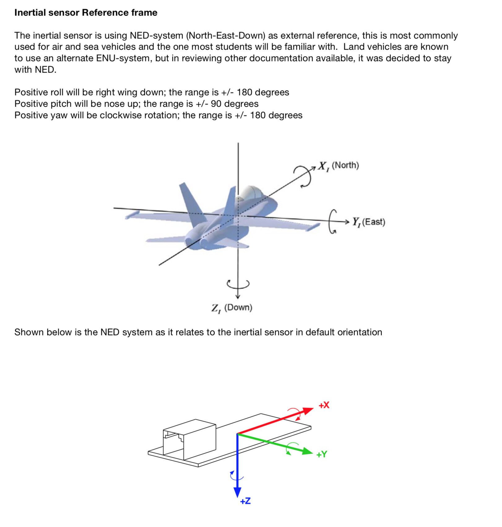

Hi! I recently made a post regarding a bug in the vex GPS sensor with incorrect wording. After further testing though I’ve found that moving the GPS sensor in a counterclockwise motion returns decreasing heading angles. e.g starting from 0 degrees and turning counterclockwise, 0, 350, 345, 330, 325, etc. Turning counterclockwise should return increasing angles e.g. 0, 30, 45, 90, etc, as in a unit circle.
This bug is an issue because c/ c++ math.h cosine and sine functions follow the unit circle. To get around this I just multiplied GPS.yaw() * -1
As I said in the other topic, this is not a bug, you are seeing the expected behavior. We use same value of heading as would be returned by the IMU, clockwise is increasing value.
Ahh thanks! Do most IMU’s lbehave like this? (as in IMU’s outside of vex?)
It varies.
We wanted to match the legacy EDR yaw rate gyro, here’s a few notes from when we were implementing the IMU.
IIRC, you can actually reverse it if you really want to, see the constructor.

pass turnType::left and see what that does.
Oh awesome! Thanks for the added info, that’s cool to see how y’all decided on the behavior. Ooo I’ll try out turnType::left as well
