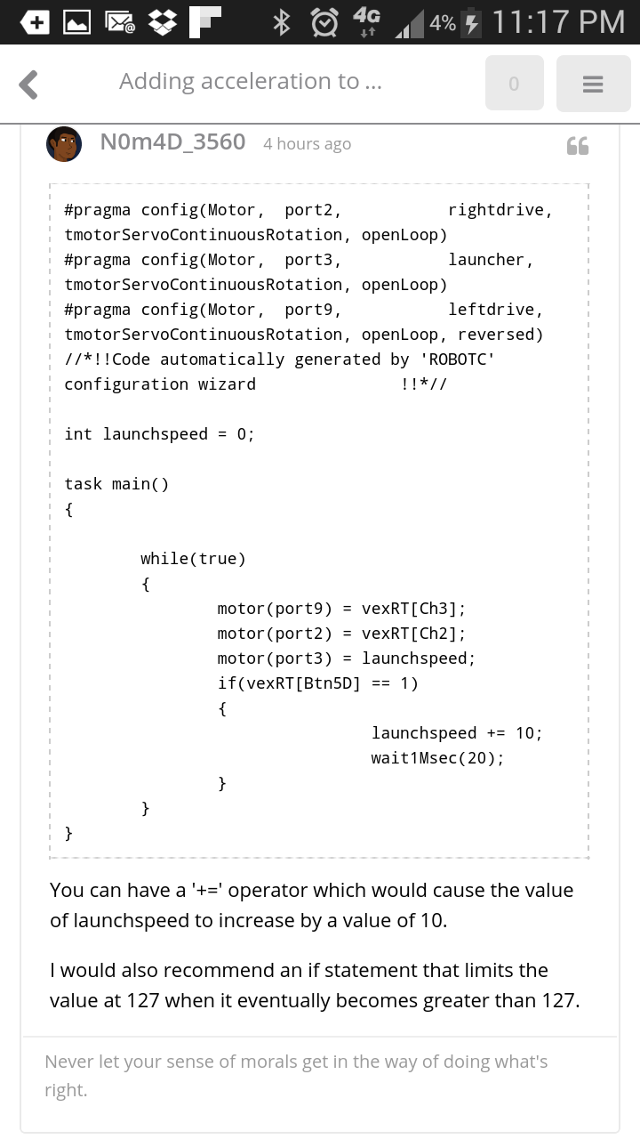

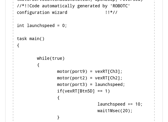

gradually increasing launch speed
In the program file attached, you can gradually increase launch speed by using +=10 and it recommends putting an if statement to limit the max to 127. I am new to programming. Can anybody tell me where I would place the if statement? We are having trouble with motors stalling and the competition is saturday. I would be grateful for any help!
