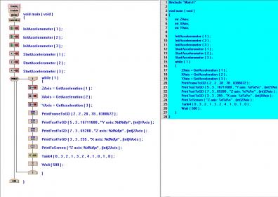

Hmmm… That’s really strange. The only things I can think of are that maybe I wasn’t supposed to save it as an integer and maybe I shouldn’t have used %d for the print to screen. Other than that, I have no idea. Here’s a picture of my code. It’s Easy-C Pro if I haven’t mentioned it yet. :confused:
EDIT: Oh and, I’m a 7th grader so I have no idea what you’re talking about when you say “Back to theory again, if you add the X value (offset by resting value of ~500) to a running total, the running total should be proportional to the current velocity in the X direction.”. Could you explain? Also I’m just using the accelerometer to measure tilt now, so I’m using the print to screen to figure out the value I want for the counterweight to move.

In the future, if you can scout around to find ways to cut and paste code as text, it would help a lot, since that jpg was unreadable. My understanding is that the"pro" version allows direct text edits.

I noticed some text strings in your BDS file, so I tried running unix command ‘strings’ on it and decoded most of the program. What I found looks like this:
void main ( void )
InitAccelerometer ( 1 ) ;
InitAccelerometer ( 2 ) ;
InitAccelerometer ( 3 ) ;
StartAccelerometer ( 1 ) ;
StartAccelerometer ( 2 ) ;
StartAccelerometer ( 3 ) ;
while ( 1 ) {
 PrintFrameToGD ( 2 , 2 , 28 , 78 , 8388672 ) ;
 Wait ( 500 ) ;
 PrintToScreen ( "Z axis: %d%d\n" , (int)ZAxis ) ;
 PrintTextToGD ( 5 , 3 , 16711680 , "Y axis: %d%d\n" , (int)YAxis ) ;
 YAxis = GetAcceleration ( 3 ) ;
 XAxis = GetAcceleration ( 2 ) ;
 ZAxis = GetAcceleration ( 1 ) ;
 PrintTextToGD ( 3 , 3 ,   255 , "X axis: %d%d\n" , (int)XAxis ) ;
 PrintTextToGD ( 7 , 3 , 65280 , "Z axis: %d%d\n" , (int)ZAxis ) ;
 Tank4 ( 0 , 3 , 2 , 1 , 3 , 2 , 4 , 1 , 0 , 1 , 0 ) ;
When I compare it to my EasyC for Cortex (about to expire in 9 days),
I dont understand why you have %d%d in your Prints instead of just one %d. Try this for code in the while(1) loop:

Now that there are waits, it won’t respond to movement as much, just to tilting. I still haven’t heard back from my programmer guy with the sample code that he used.
Dude, thanks SO much! I found out why there were two %ds. Somewhere I got the impression that you have to put the directive in the actual message too. That’s why I got values of so many digits! Thankyou so much!!!
