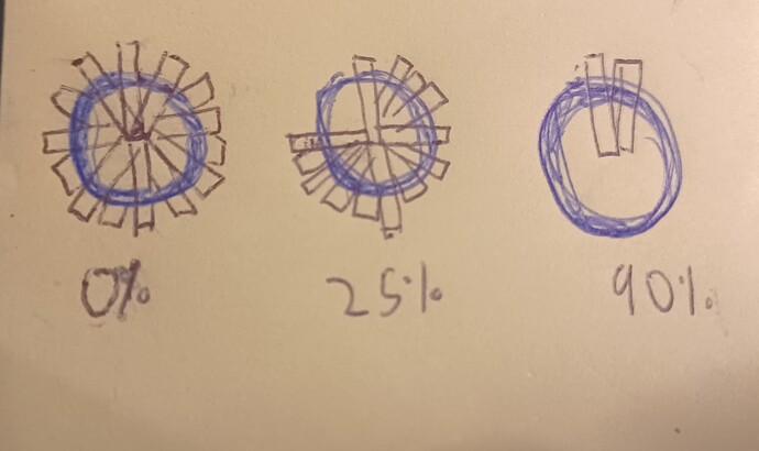

That’s kinda hard, and my solution is kinda janky, but until we have a better idea:
What you have is your circle. On top of that you have a bunch of rectangles the same color as the background of the controller (black on this diagram). At 0%, all the rectangles are on top of the circle, so you can’t see it. At 50%, only half the rectangles are there, revealing half your circle.
When the value of what you’re measuring is below a certain percent, then one of the rectangles appear (like if % < 10, rectangle A(position) or smth like that). However, this function would have yo be repeated for each rectangle, which might use a lot of code space
Wow, that’s an impressive solution at first glance. But I understand that you can only use ASCII characters without being able to modify layers or the rotation of the characters
Oops…
