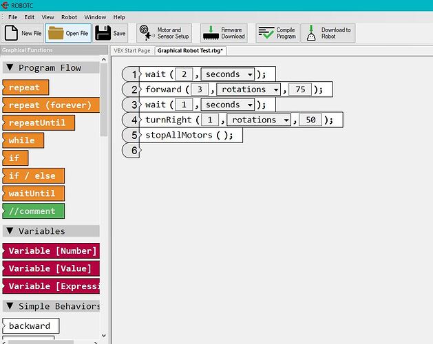

Are there rules or constraints for Graphical Robotc in terms of downloading to a Vex EDR cortex robot? Do you need encoders attached for it to work? We are on Windows 10 desktops, set to USB only, and when we download a simple program such as forward for 2 rotations, etc., we get no response from the Vex robot. We are having issues with robots running it…we have no issues with regular RobotC. Thanks for your help!

Thank you I appreciate it, I have the Sensor Debug window open and I can see the power to the motors and the encoder values; this is so strange.
Would it be possible to paste the code or upload the file of the program being used?
Here it is, very simple program, but I have not used Graphical before, just text based RobotC.
I’m a new user, so forum will not yet let me upload a file. Below hopefully is a screenshot.
Capture
My guess is that without encoders, the Cortex does not know when rotations are or aren’t complete.
Try changing it to seconds rather than rotations.
