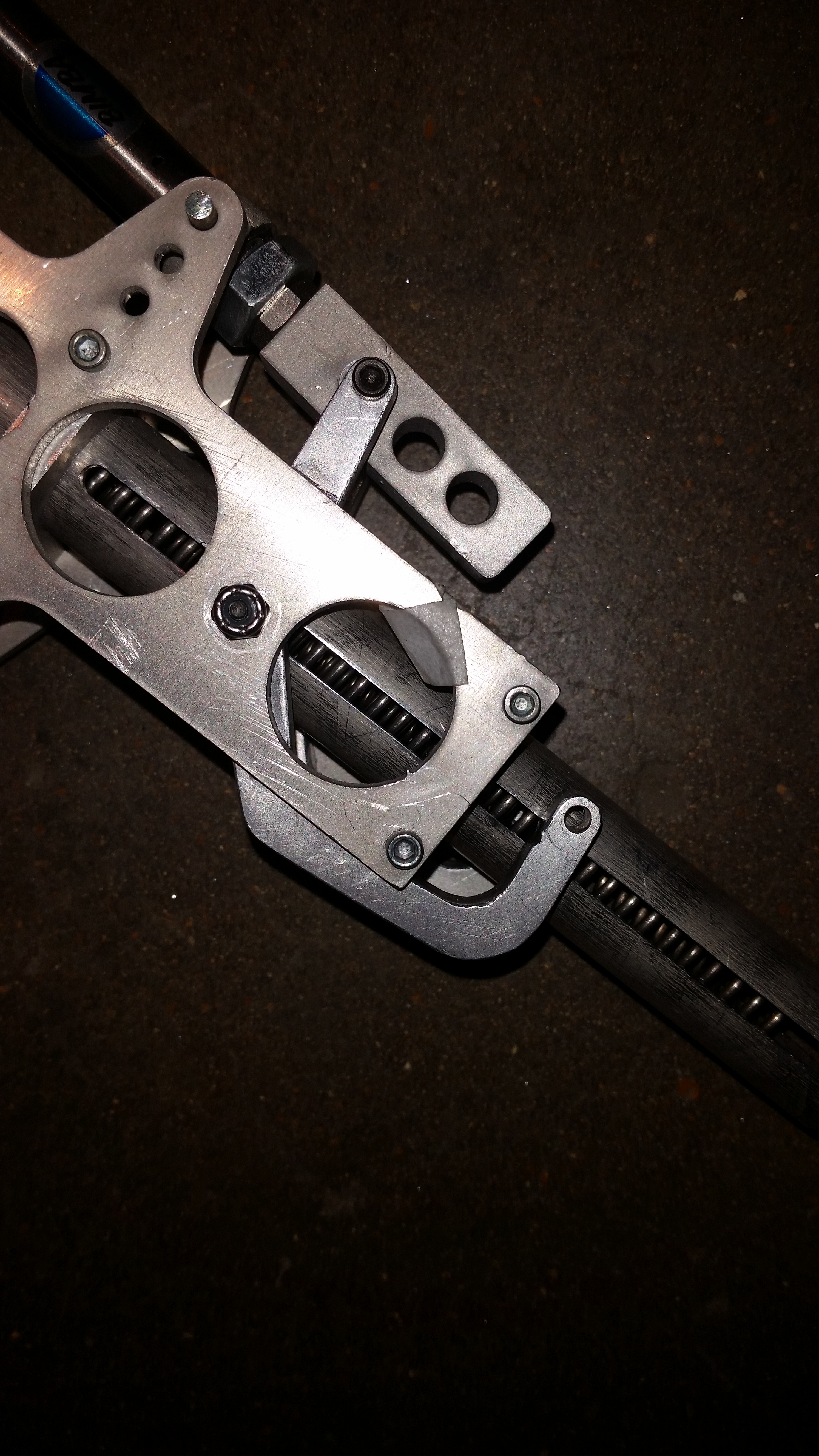

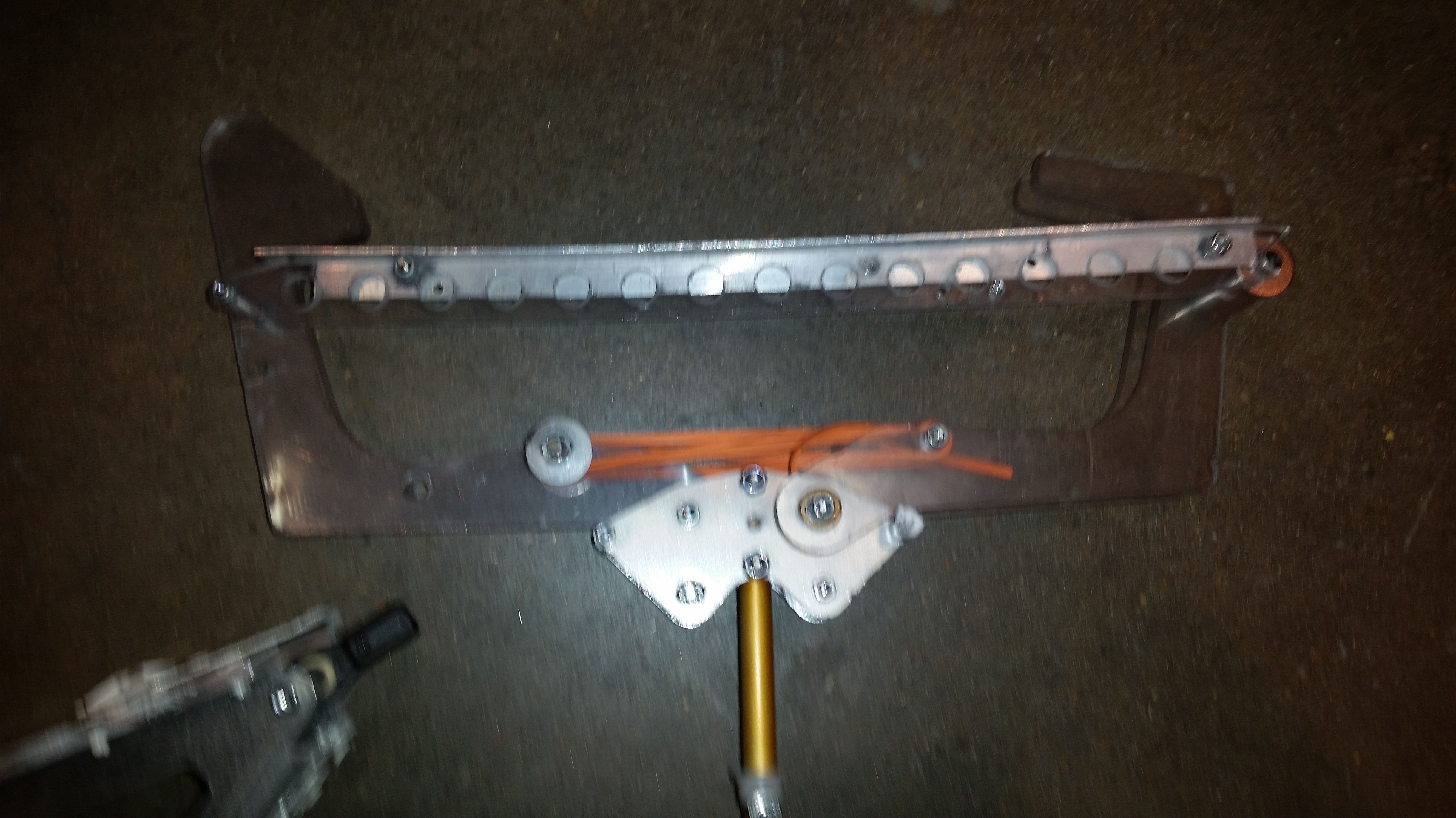

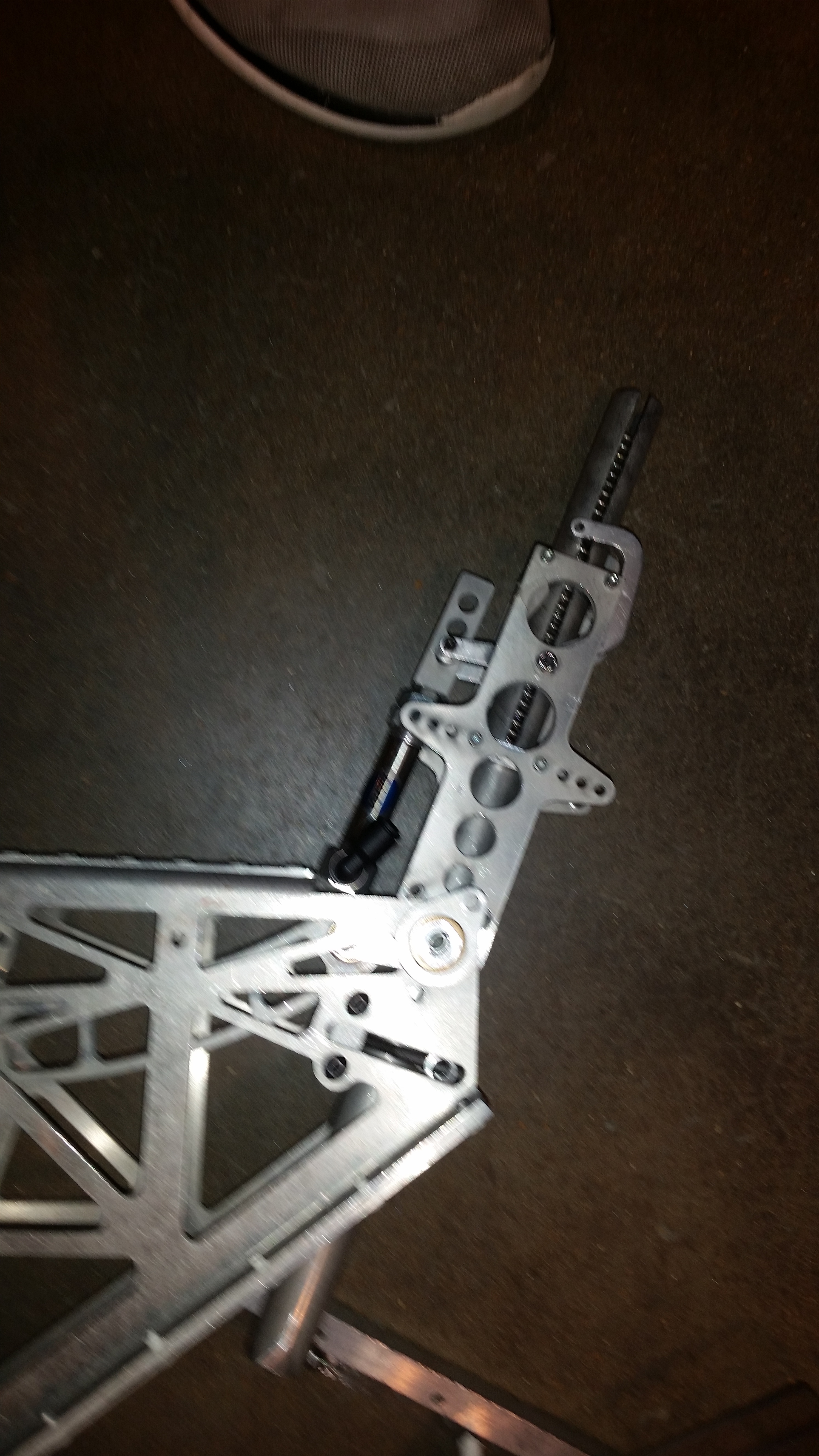

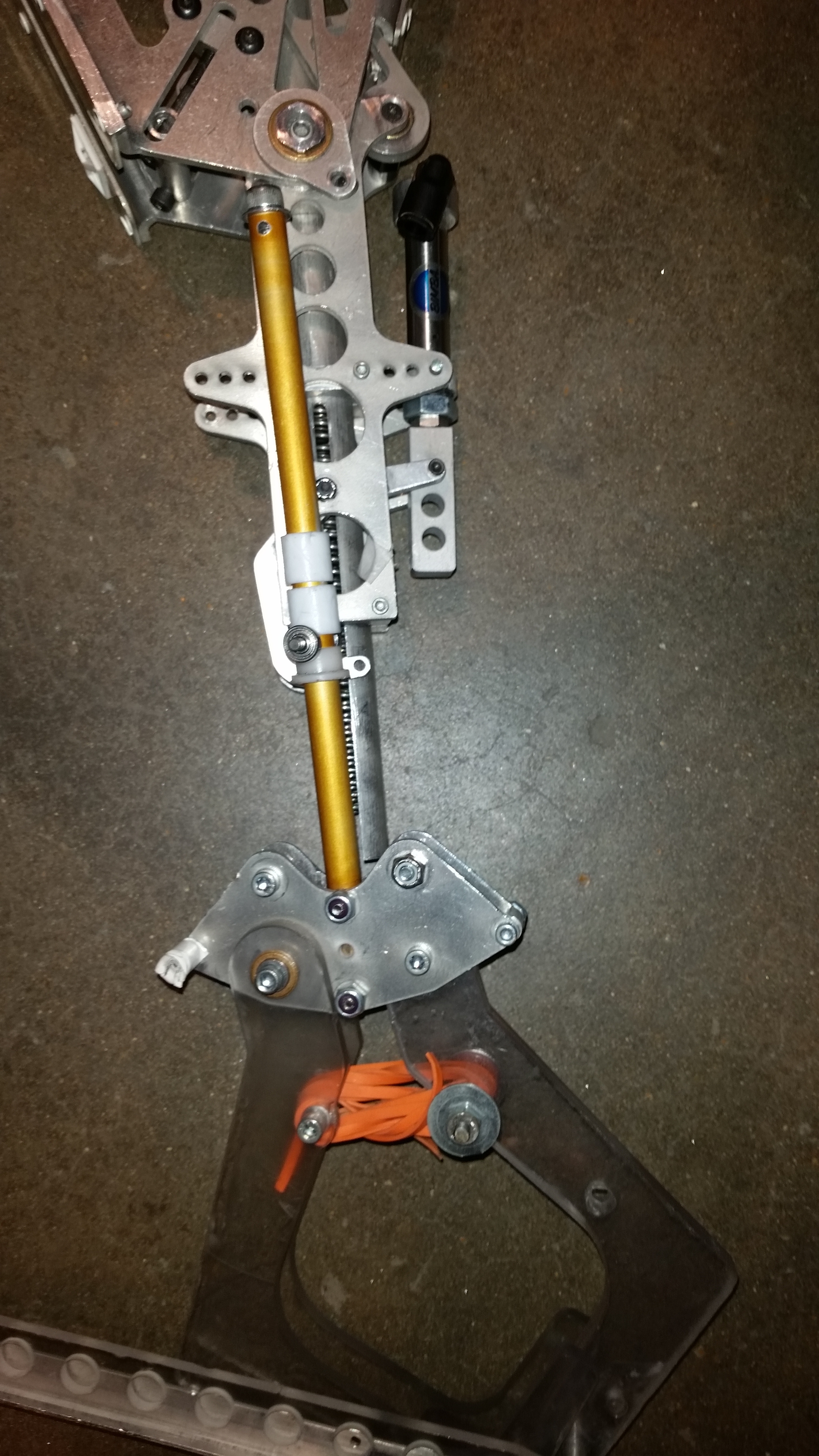

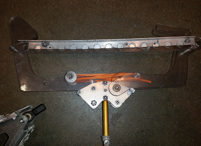

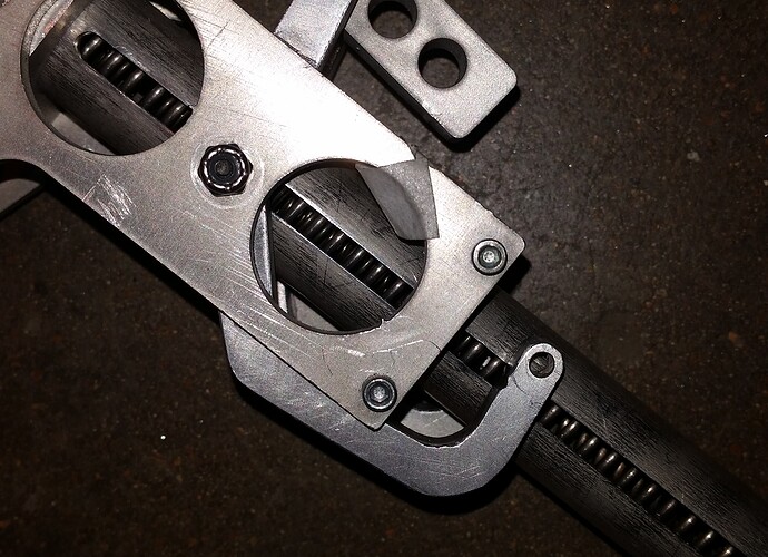

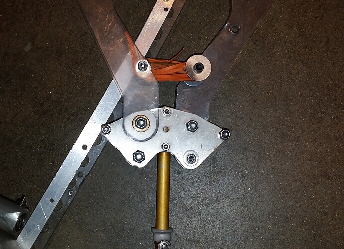

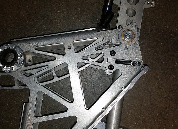

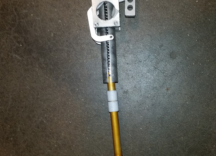

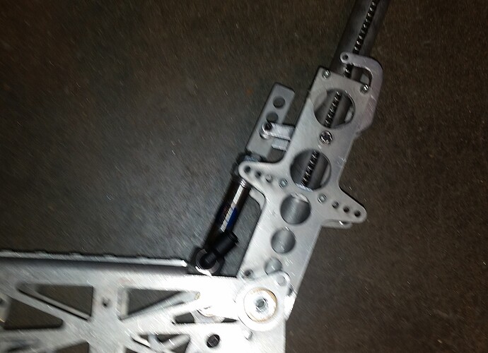

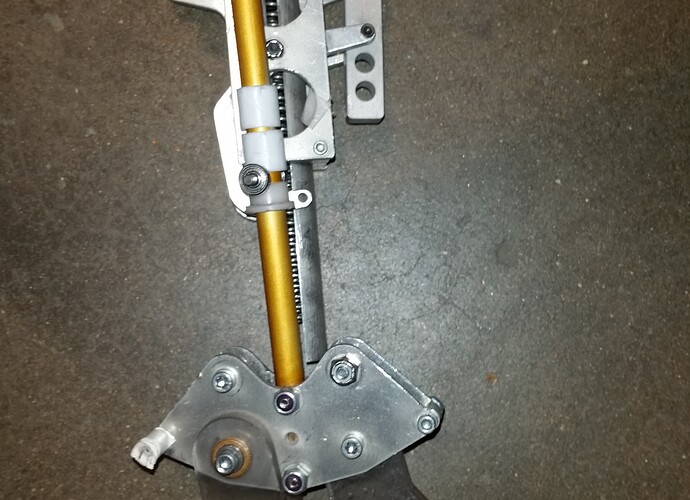

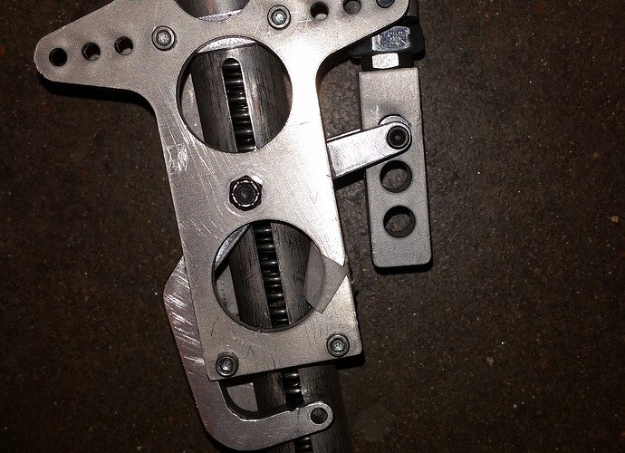

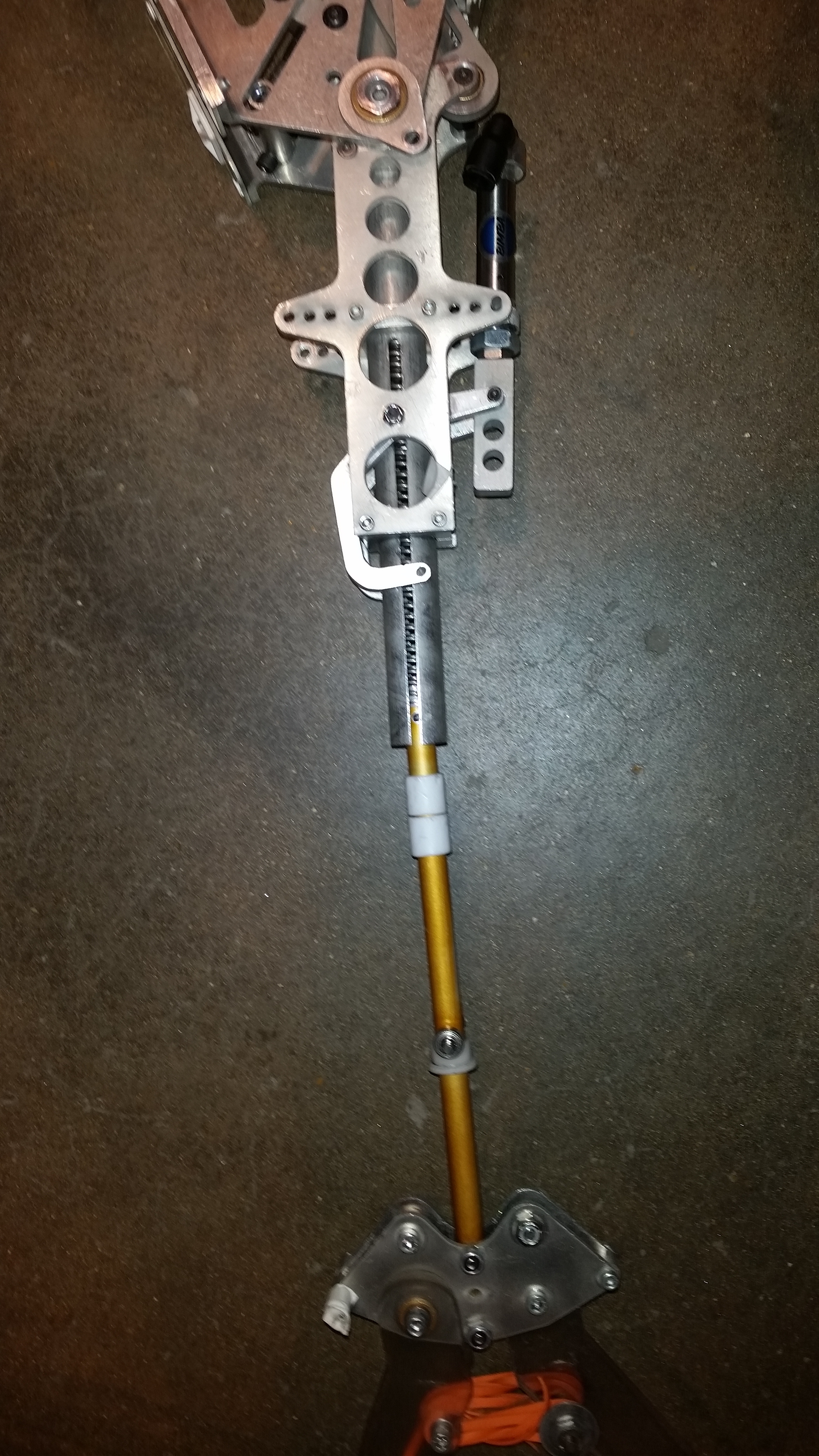

more details on that, here are some up close of the hook and launcher I got at champs this year

Assuming that this would be intended to grapple on to the pole and hook on like a claw, as would the grappling hook pics from 118’s frc bot pictured in collins post above, grappling hooks are relatively feasible. While a grappling hook that was actually a hook that would hook the top of the pole would be amazing and win ALL of the awards, i very much doubt its accuracy. By just firing the claw design at the topish area of the pole, and making sure you have an insane number of rubber bands to snap it shut when the pole knocks out the brace, it could be a very effective climber, requiring you to easily winch yourself up, possibly with one motor. In addition, the release can be triggered by this one motor with relative ease, making a fast, motor efficient climber. I for one will definitely be prototyping this.
