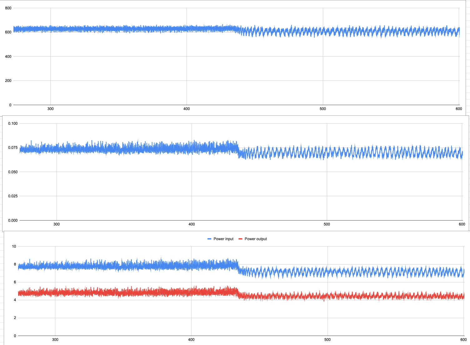

Guide: How to graph motor data
I have gotten a few questions about how I graphed my motor data in a spreadsheet, so I decsided to make a quick guide.
The goal is collect and display motor data.
I use #include <iostream> to output the data to terminal.
Now formating is really important. I use comma separated values formatting because it allows me to use a .csv file to store my data. (I wonder what csv stands for :man_shrugging: :man_shrugging:).
Time is really important to graph when things happen, but it doesn’t necessarily have to be the brain’s timer. If you want you could have a timer related to when a shot is fired.
Then add the propper motor inforation you wan to output.
I use a code block that looks simliar to this depending on what I want to output inside the driver ctrl while loop(just make sure it loops).
  std::cout << Brain.Timer.value() << " , "
  << Motor18.velocity(rpm) << " , " <<  Motor18.torque(Nm) << " , "
  << Motor18.current() << " , " << Motor18.voltage(volt)
  << std::endl;
This outputs the: time , velocity , torque , current , voltage
Run the test and the program will output the data in terminal. Now I copy all the data to clipboard and paste it into a csv file or Excel (not sure exactly how this works for windows bc I use a mac).
Issues that arise for me is that if I try to output too much data at once the data doesn’t sent correctly to the terminal. I solved that by increasing the amount of wait time for the loop.
