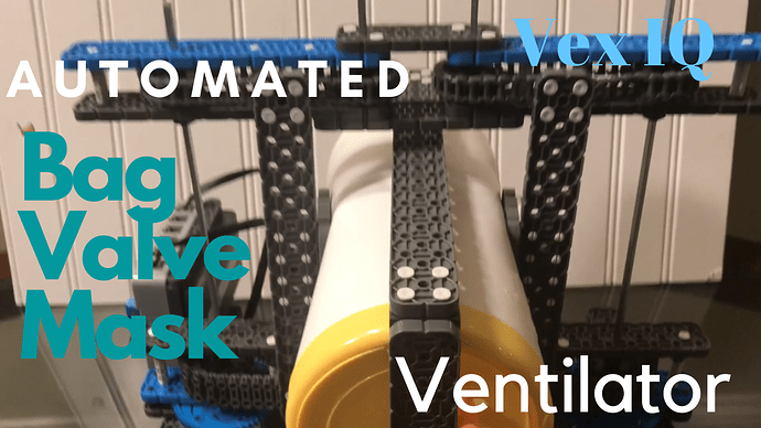

Guys please HELP out in the COVID - 19 CRISIS by doing this **VENTILATOR BUILD**
I worked hard on making an automated Bag Valve Mask Pump. This is essentially a VENTILATOR. There is a huge demand on ventilators right now. So i discussed a few models and linked the code down below the video. Please watch it and if you plan on making on reply so we can help out the doctors.

Cool idea but Doctors only use FDA approved ventilators. Ventilators are life saving and potentially life-ending devices if failures occur.

Yes, that is true but if this can get popular we can possibly get some doctors in on this. Through that we can tone the product and it can save lives. I still encourage others to build this, so if someone nearby that may need a ventilator can not get their hands on one, this could possible save their lives.
Please dont use this on humans - if they need a ventilator, they need one that can work 1,000,000+ cycles.

That is why if this can get popular we can get a doctor to help us out with this. This is a prototype but with a doctor helping out we can get something very accurate.
Thanks Lyncas for jumping in here. Designing things like this sounds cool, but it’s really a lot of work. There is a good video of the Tesla setup and how complex the let air in, let air out, how much to push, how fast to push, etc. Tesla ventilator Model Zero and Pre-production
The post shows an respiratory bag which at best is to be used for emergencies. Having gone through EMT training, these are not long term things.

Have a doctor help middle/high schoolers with near to no medical background build a machine that people’s lives depend on? Instead of having them help people in a hospital? Not to mention getting this approved for public use takes months (maybe years). May as well just let Ford and General Motors make their projected 1,500 ventilators in a month.

I don’t mean to be rude, but do have you actually been reading any of the replies in this thread? It’s not like you can just go up to a doctor and say “I have this piece of medical equipment, please use it even though it has neither been rigorously tested nor FDA-approved”. That would not go well for you. So please stop saying “If we can a doctor on this” because that is not all how stuff like this works. Furthermore, while it is good that you want to help save lives this idea is not a good one. As lyncas said, if a ventilator fails, someone probably dies.
