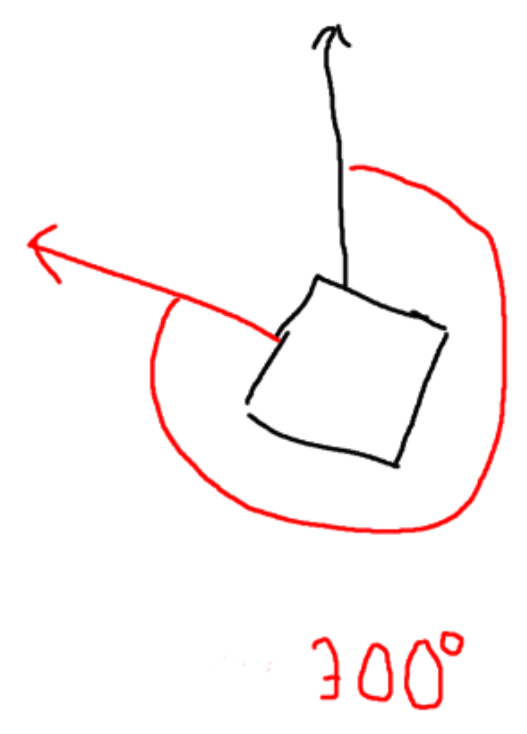

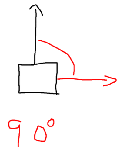

I was just wondering is anyone could actually fully explain how to use gyro sensors. I am unsure of how they work.
They show how much you have spinned, from 0 degrees to 359 degrees. Keep in mind that the sensor isn’t perfect, and it can have some errors.
Here’s some diagrams.
This one shows the robot has turned 90 degrees.
This one shows the robot has turned 300 degrees.
