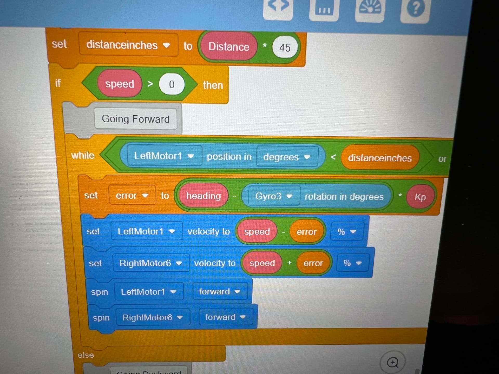

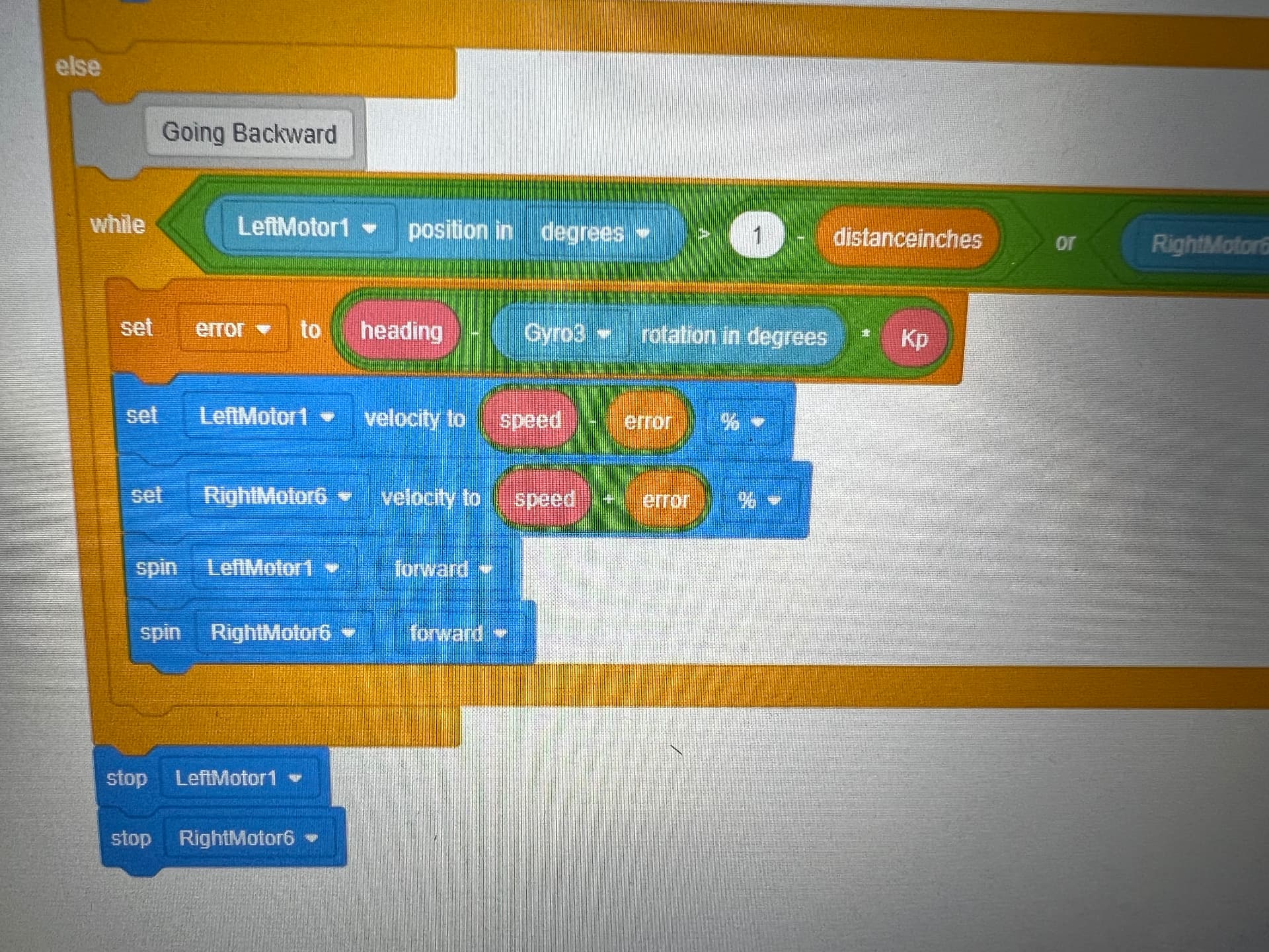

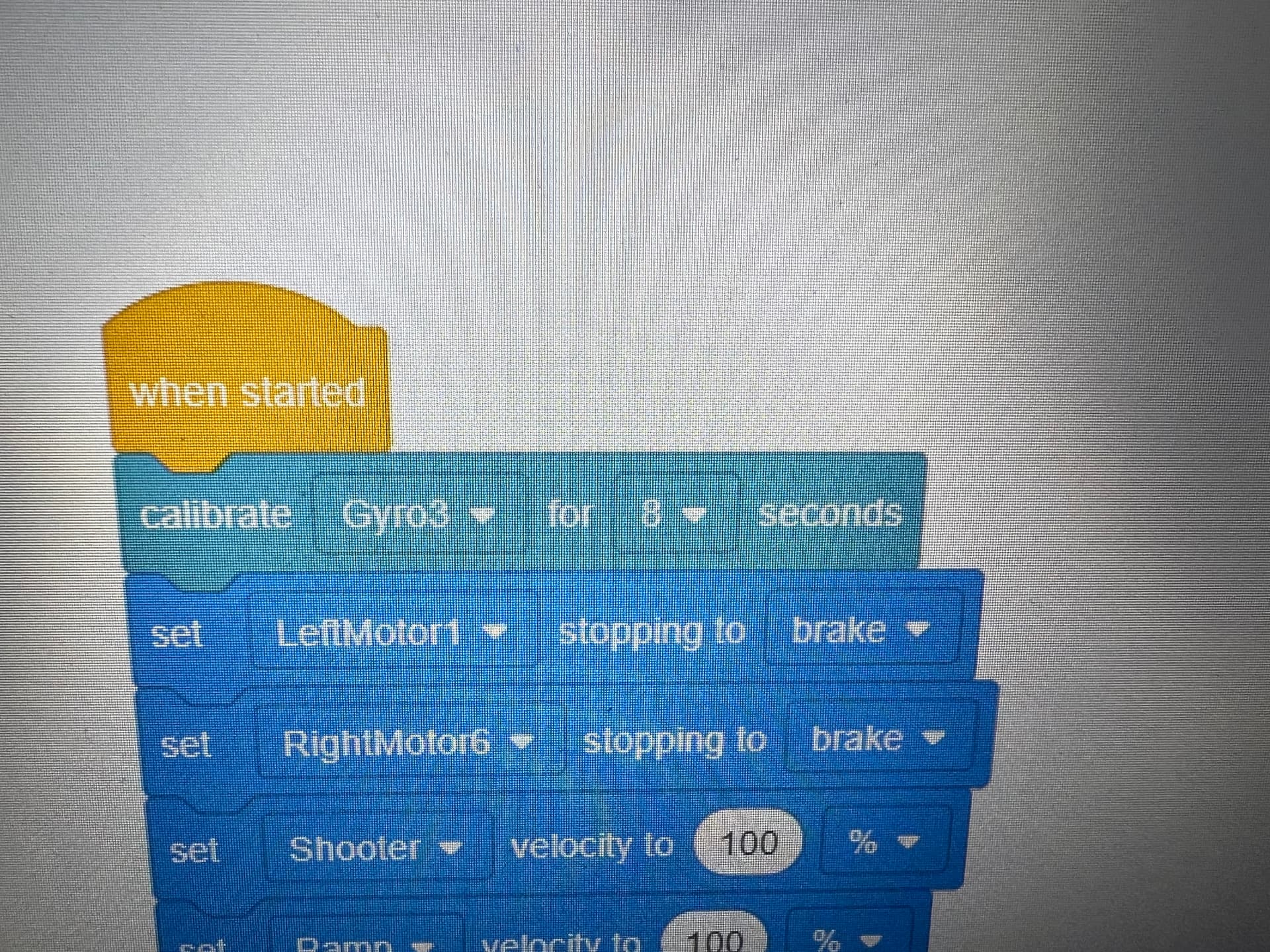

Where do I put that in my code? “0-gyro”.
These are the subroutines where I have gyro:
Thanks
You do this
