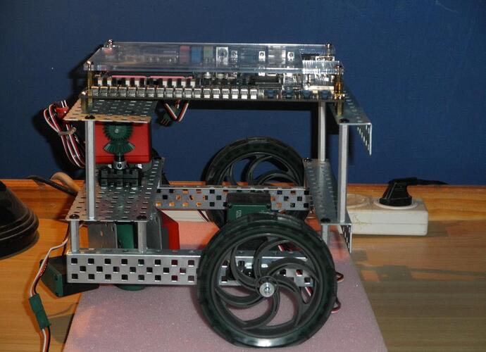

Hello,
I have a Vex kit, and I am using its sensors and structure to build my robot.
For the “brain” I am not using the Pic18 that I got with the kit, I am using FPGA DE2 board from Altera.
Does the 3 wire motor I got in the kit have an H-bridge build in?
If I want to use a different controller then the Pic I will need to add an H-bridge.
Does it matter what kind, who can I design H-bridge for vex motor?
Thanks in advance
Yes, the 3-Wire motors do have an internal speed controller. It’s like an H-bridge, but with some external circuitry. Instead of having two digital outputs feeding to the H-bridge, you can control the motor’s direction and speed using a single wire. You send PWM signals from a PWM output on your board. Sending pulses 1 milleseconds apart will cause the motor to spin in one direction, while sending pulses 2 milleseconds apart will cause it to spin in the opposite. Sending them 1.5 milleseconds apart will cause the motor to stop spinning - neutral.
So, no, you do not need add an external H-bridge. The PWM wire (wire you send signals to) is the white wire. The red and black are the power wires, and you can supply anywhere from 4.4 to 9.1 volts. If I recall correctly, the datasheet used to say up to somewhere around 15 volts. Overvolting you motors will decrease the life of them, however. So unless you really need that extra horsepower, I would suggest that you feed it no more than the 9.1 that the datasheet tells.
Yes, the 3-wire motors and servos have internal H-bridges to drive them. Your controller must generate TTL-level timed pulses on the white wire to control motor speed and direction.
The pulse should be generate about 60 times per second, and the width of the pulse determines the motor’s direction and speed. If the pulse is 1ms, then the motor runs full speed one direction. The motor stops if the pulse is 1.5ms. 2ms makes the motor run full speed the other direction. Pulse widths in-between these values provide proportional speeds.
The 2-wire Vex motors do not have internal H bridges, so you would make use of a Motor Controller 29, which basically makes a 2-wire motor behave exactly like a 3-wire motor.

I design my robot like a forklift (without the lift :))
Meaning three wheels while two stationary wheels are in the front and the third wheel in the back is responsible for speed and direction of the robot.
Do you think it will be able to move with a DE2 board, 9[v] batteries and sensors on it or will I need to add engines to the front as well?
I don’t think you’ve provided quite enough information for us to give you a useful answer. For those that don’t know what a DE2 Board is, the user manual can be found here.
9V is a reasonable voltage to run Vex motors, but the size of the battery matters. A 9V transistor battery cannot provide enough current to run your robot. A 9V 2000mAh NiMH or NiCd battery pack would probably be fine (though at full charge would be a bit high for the motors).
How do you plan to wire the motors to the DE2 board? You could wire it such that the motors and the DE2 board have separate batteries.
Your photo shows Vex motors attached to all three wheels, so I’m not sure what you mean by “add engines to the front as well”. It doesn’t look like a particularly heavy robot, so I think it should have enough power as it is built (assuming a suitably sized battery is used).
