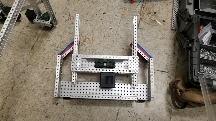

My teams H-drive is sliding around and getting caught because it’s not getting enough traction. I need help!
20190829_145346
I have an H drive module. The module is spaced down slightly with a nylon washer. This gives it sufficient contact with the ground.
Building a VEXIQ robot use these shock absorbers to keep the center wheel on the ground. That will let it push up and down as the robot moves. Our teams like the softer ones.
Of course you can build your own for VRC.
