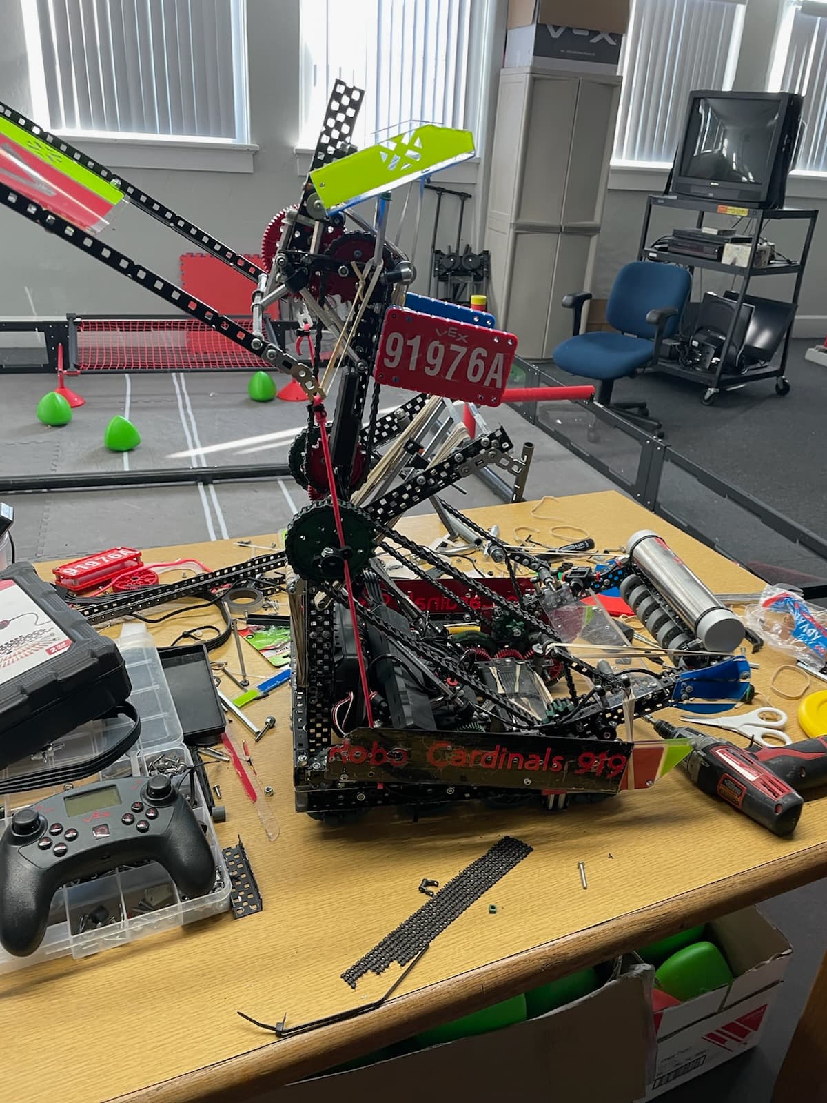

I may have a really unique design for a B-tier hanging meach that could be pretty simple. So my hanging mech is completely passive and how it works is my launcher will lift up and then my hanging arm will be at the height to hang. The arm is rubberbanded down enough to lift the robot and held by high-strength axles. When the robot runs into the bar the axles will move out from under the arm and hang the robot.
Here are some photos please don’t hole count.
This mechanism is completely passive and uses no positions or motors to hang other than the one piston that lifts the launcher.
