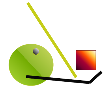

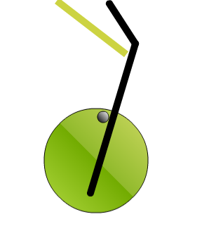

With my robot, my anti-tips are connected to the lift (It raises and lowers, not linearly slide out). Whenever my arm raises, the anti tips on the back of my robot lowers. When my arm lowers, the anti tips raise. To reduce clipping on the fence, the anti-tips are connected by one connection on the gear, and rubber bands hold the arm upwards. Whenever the arm lowers, standoffs on the gears push the anti tips down. When it raises, if the fence is clipping,the gear will turn, but the mechanism will stay down until the robots anti tips are out of the way. When time to lift, since the arm lowers when lifting, the anti-tips raise/retracts, making the anti-tips rotate into the robot, allowing the assurance of a reliable hang. The anti tips work something like this:
The first picture is no strain(lift in down position, no fence), the second one is strain (lift in dump position), and the third one is strain in down position(fence). This method is for anti-tips that have the capabilities to reach much farther than other anti-tips, as well as being able to retract upwards to do a high hang.
Key: Green = Gear, Silver = Standoff, Black = Anti-Tip, Yellow = Elastics, Orange = Fence

This mechanism is extremely useful, and has some pros and cons. The pros are that if there is too much velocity when tipping, then the anti-tips will also lower the lift as the force is being applied, which helps with prevention of falling. This is also useful because it is also very reliable too, and can save you if you are extensively light. The cons are that if there’s an object below you, it can cause some issues and you may have to push the object out of the way before you raise your lift.
That’s actually really cool. I think we will try this. That works perfect for us.
