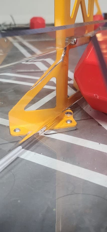

We drove our robot into it by accident and it cracked…
2 recommendations:
  1. Drill a small hole at the end of the crack to prevent it from propagating further. From the looks of it, I’d bet this crack does not prevent the goal from acting pretty much as normal, and suspect that it could still be used for practice.
  2. Call/Email Support if it gets worse/fails completely.
Interesting that crack starts from screw. From EP perspective, goal still functional. If a whole piece fell off, then we have a problem.
Yeah, it still workd fine, but the crack actually starts from the corner of the polycarbonate, not the screw.
We’ve done this, and I don’t think we will have too many issues, but after a full season of use, there probably will be more cracks.

Old boomer eyesight, could not tell exactly from photo.
