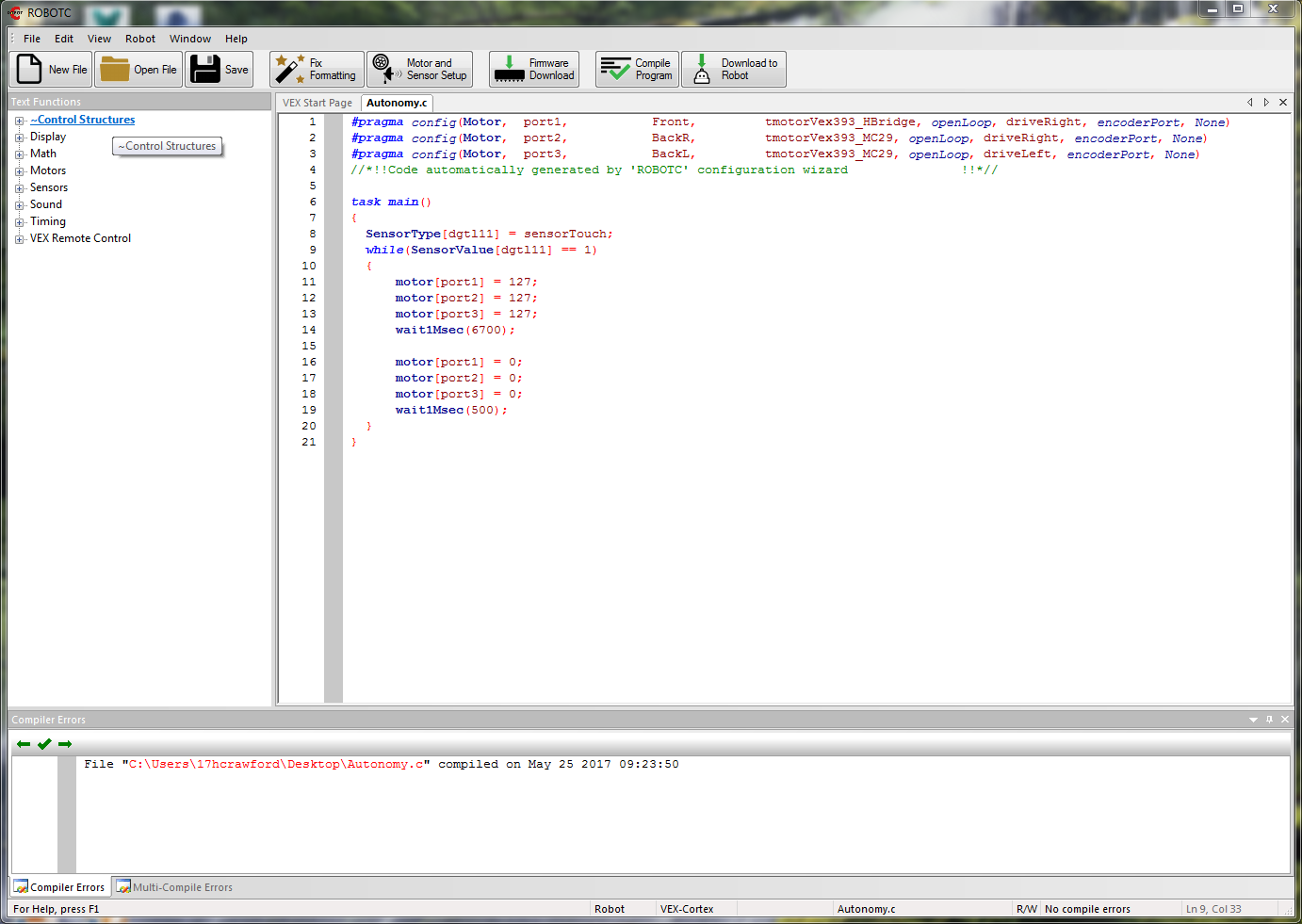

The goal is to press a button (one of the bumper switches) so that the robot goes maximum speed for 6.7 seconds (how fast it takes our robot to travel the distance of the race track) and then stops at the finish line.
I have attached a picture of what my current code looks like and what I’m working with. If someone could please help me by telling me where i’m going wrong, or if someone could write the code for me that would be much appreciated! If you have any questions/concerns about the robot or process please ask so I can clarify!

is the sensor plugged in to dgtl port 11?
Do you keep the touch sensor depressed? while statement
or do you want the program to keep running even after the sensor is no longer depressed? if statement
One quick thing I noticed: do you have the button switch configured as an input? I don’t see it in the pragma statements.
Yes, the sensor is plugged into digital port 11. I want to be able to press the button once at the start line and have it go all the way to the finish without being held down or anything.
I just know I have it plugged into the 11th slot in the digital part. I’m pretty sure it’s an input but I could be wrong. Like I said, I don’t know what I’m doing when it comes to programming.

I added the switch, but i’m not sure where to go from there. People are saying to replace the while statement with an if statement, but then what?
So I changed this, but what else needs done? Don’t if statements need an else in there somewhere? And do I still need the == 1 or what? Sorry for the abundance of questions but I don’t know how this stuff works.

You need something along the lines of:
If sensor == value {
//action
You may want to put this inside of an infinite while loop (While TRUE or While 1 == 1) so that you can repeat the behavior by pressing the button again without restarting.
You need to put your code in a while true loop. If you aren’t pressing the button when the robot turns on, the while loop evaluates to false and your program ends.

Okay so your on the right track. What happens currently is the value is 0 at the beginning so the program ends. You need to be constantly checking the value of the button. And a lot of the suggestions so far would look something like
This is always looking at the state of the button and any time it is pressed the robot will drive forward.

So I added a little bit to my code, but it still doesn’t work and I don’t know where to go from here. Please help.
You need brackets after the if and ending after the second wait. Currently the if only controls whether the front motor runs. What exactly is happening as that may help with further debugging?
I noticed that right after I posted the screenshot, sorry. I put them in but it still doesn’t work. The motors spin up for the 6.7 seconds indicated in the program if I press “start” on the program debugger on my desktop, but pressing the button in digital 11 does absolutely nothing.
With this setup, everything happens as described in the post I made above this one. If I changed the 0 to a 1 literally nothing happens at all no matter what I press/click. Why wont the button plugged into slot 11 work?

When you call digital 11 you say in the program dgt111. Try switching it to dgt11. Hope you figure it out :slight_smile:
Also just double check to make sure it is plugged into digital 11 and not digital 10 or 12 or something like that.
I’m not sure of the terminology to use, but in the program “dgt#” isn’t an operation per say, it has to be “dgtl11”
