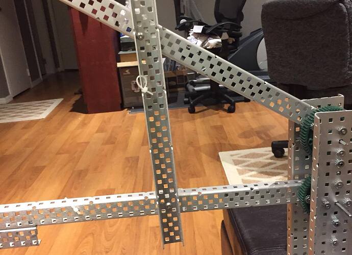

Hey guys so our team currently wants to add a supporting arm to our throwing arm and we are having trouble. We are a back dumper and are utilizing a gear system of 12-60-12-60. So the supporting arm kept on getting stuck on a gear or axel and prevent our throw arm to fully extend, does anyone have a idea to how to make it work? any pictures or video would be highly appreciated thanks!

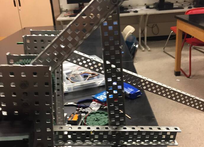

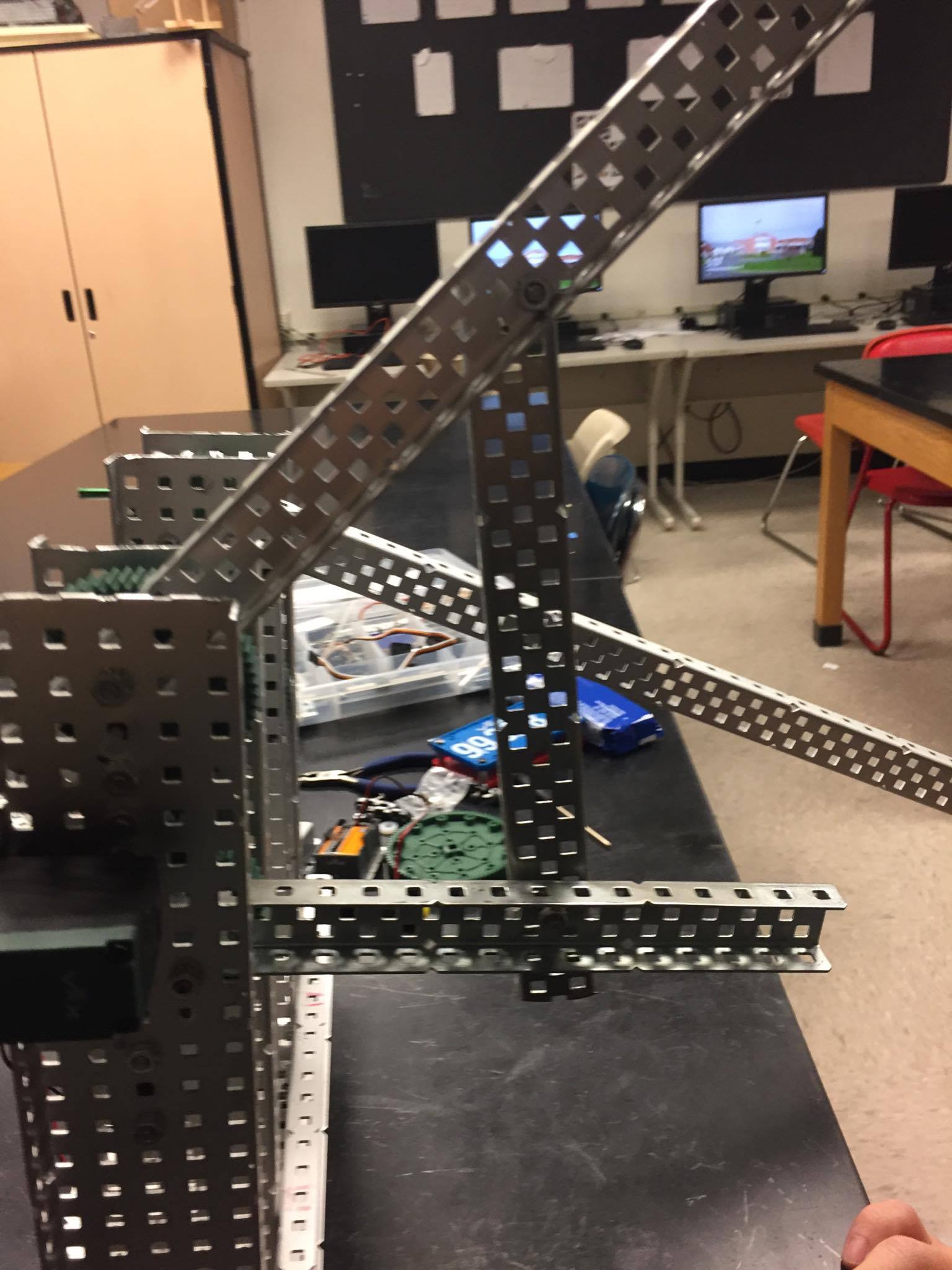

we have some! in the picture the supporting arm (lower arm) would only be allowed to go to a certain distance which limits our throwing arm to go up n dump.

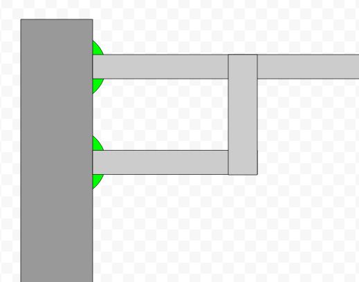

This is what I would recommend. Setting pieces at angles like you have there doesn’t work.

We have motors on the 12 tooths. 12-60-12-60 is our gearing ratio. We tried doing it parallel like you had in the picture but it doesnt work.

This is a good start, but it may not lead you towards where you want to be with a backwards dumper. Mess around with the placement of the joint and see what works for you

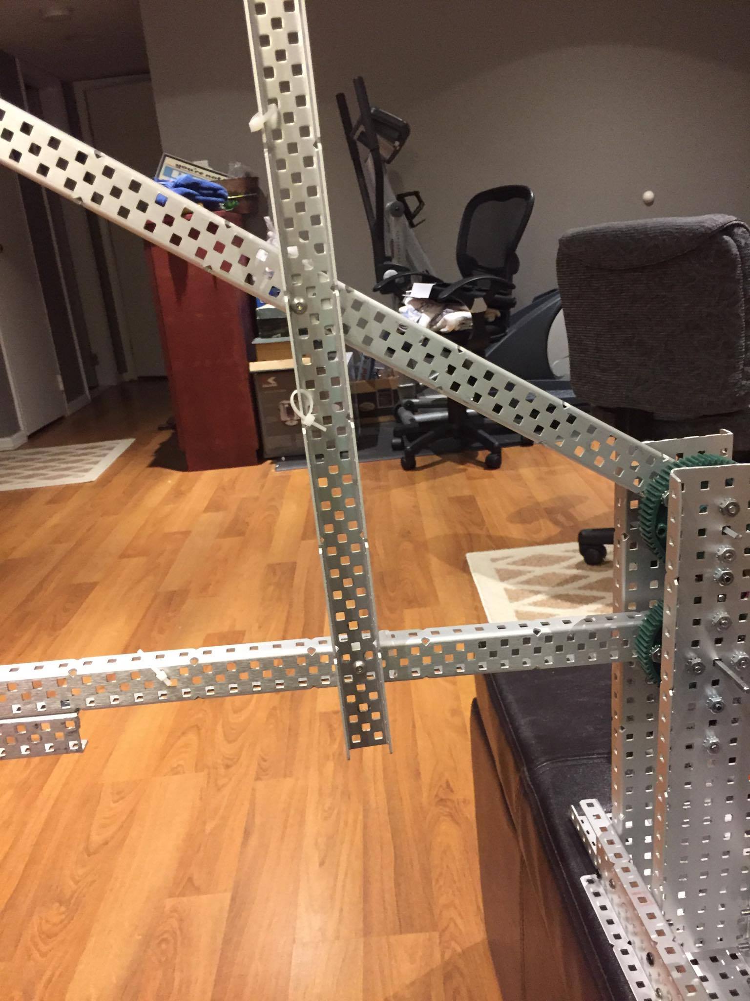

We have a backwards dumper too. If it would help I can send a picture of the arm and how we have that set up.

we have 3 motors on each gear tower so a total of 6 (pictures were a prototype). Were gonna try to create more distance between the main arm and the support linkage. Planning on either adding more idlers or drive them separately so that 2 motors are driving the main arm and 1 motor is driving the linkage independently.
Pictures of yours might be useful to give us a reference
