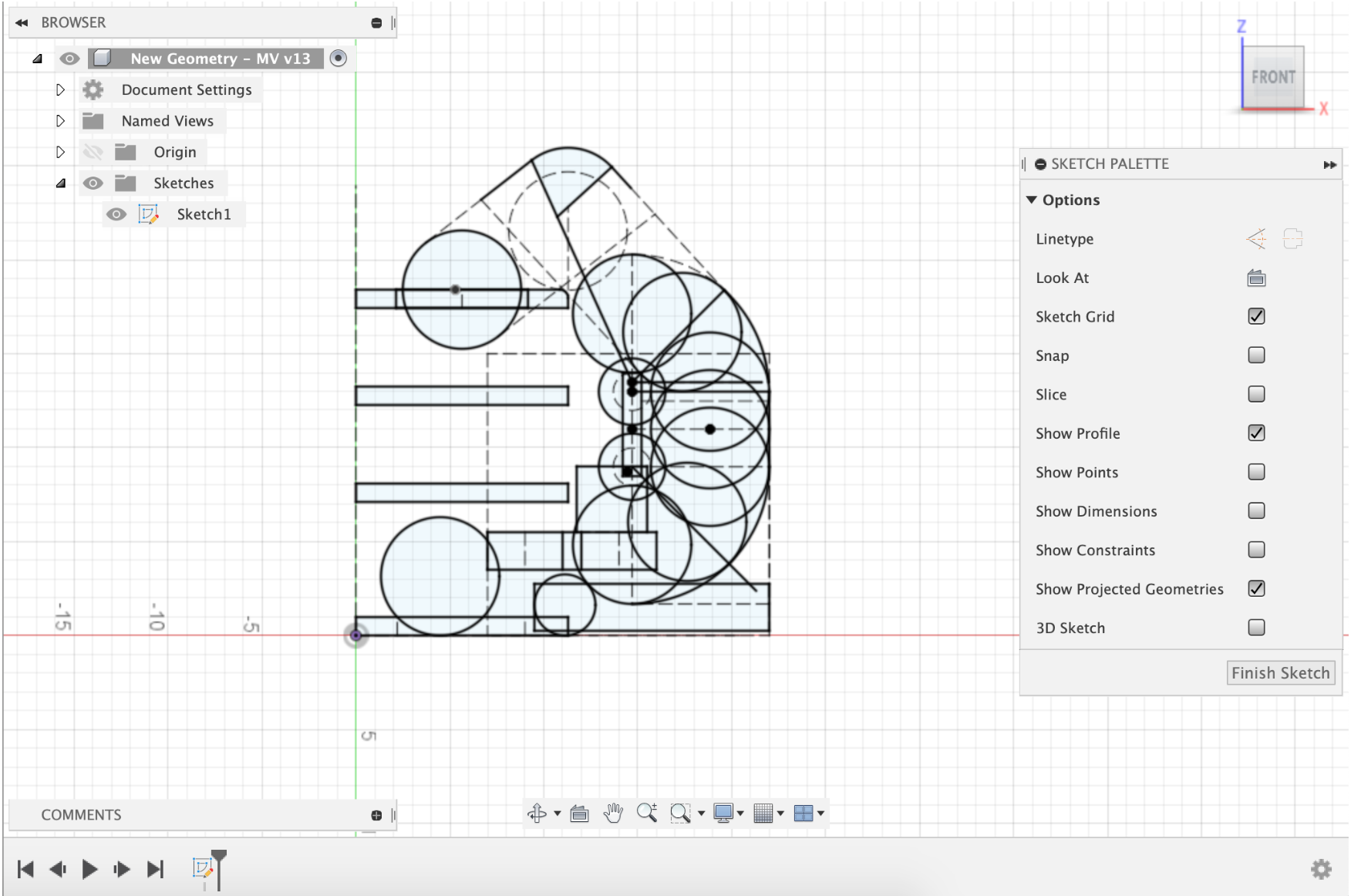

To add to this, if you have access to a roll bending machine, you can bend a mold of a specific radius and heat the polycarbonate over that, and then cut it to the correct arc length that yields your desired exit angle. To find these values, you’re either going to be really good at geometry or just use CAD.
Ex:
Here’s a rough example of how the hood geometry is derived (from my robot):
Screen Shot 2021-02-17 at 3.14.07 PM

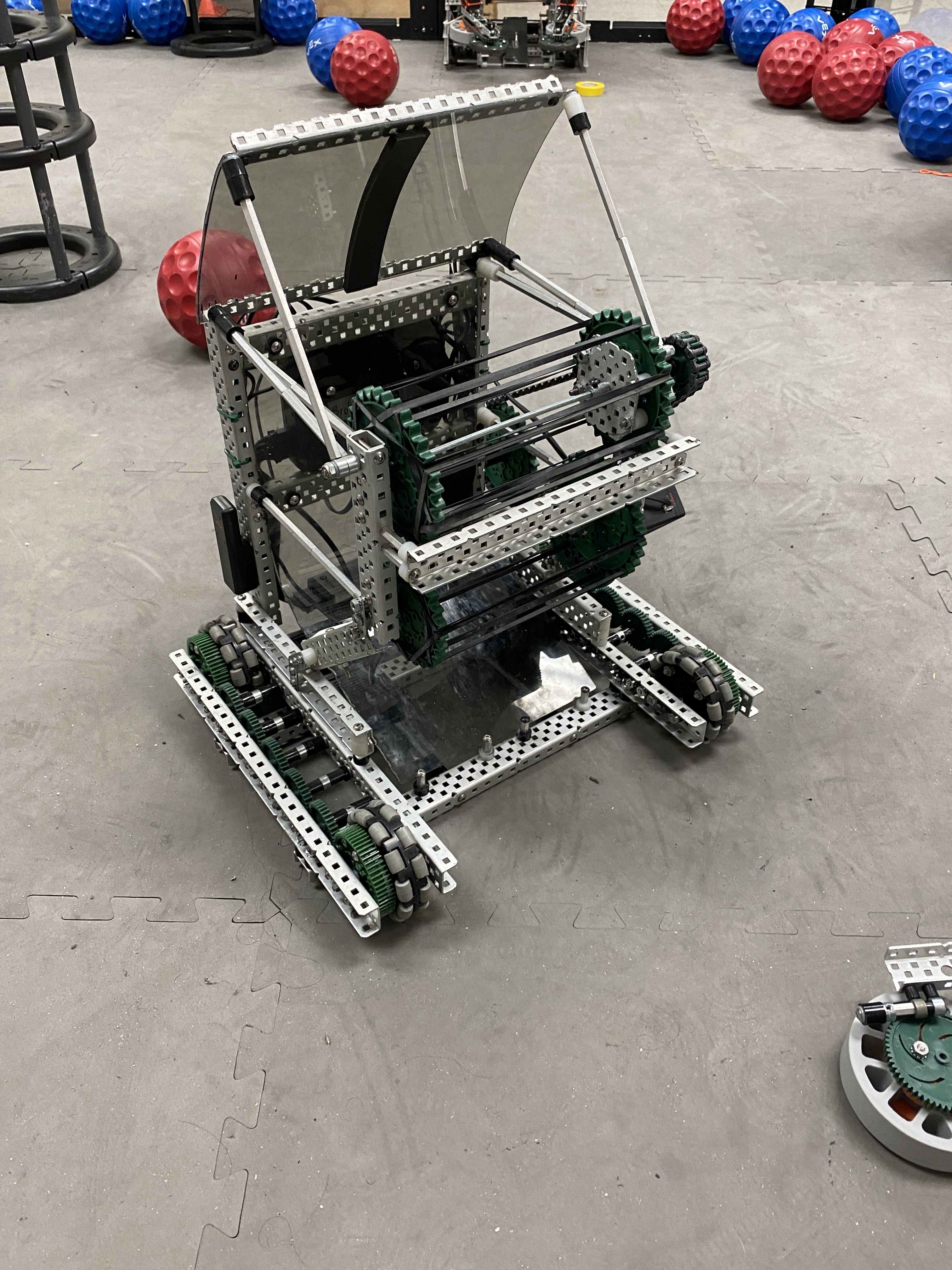

And how it’s since translated in practice:
IMG_8383
Additionally, I’d make another mold of a slightly larger radius and rigidly screw it into the first piece so that the polycarbonate cannot easily flex. This is an overkill solution by the way and doesn’t make sense for this year’s game. But if you insist on heat bending, this is the best way to go about it.
