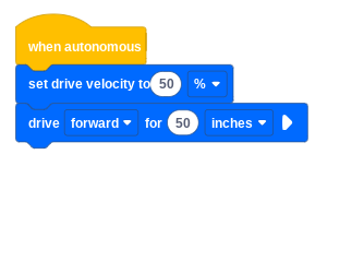

My drivetrain keeps stopping in the exact same area no matter what i do I even changed the location i’ve used millimeters instead of inches and to top it all off it drives fine I don’t know whats happening pls help
Could we see your code please?
Yes here

Looking at your code, this is a good thing. Are you saying that your robot is stopping in the wrong place?
Yes, by what I measured plus 5 more inches it stops in the wrong spot

What brake mode is the drivetrain in? If it is in coast mode (I think coast is the default) then the drivetrain could “glide” past the desired stopping location. Try finding the set brake mode block and setting the brake mode to brake before you run the drive command.
The problem is that it stops 27 feet before the desired position (Yes I measured)
