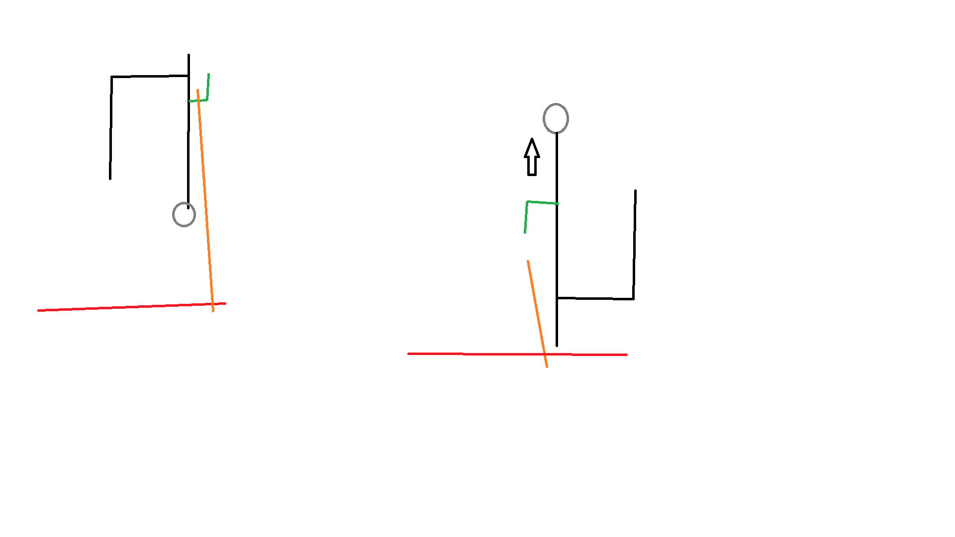

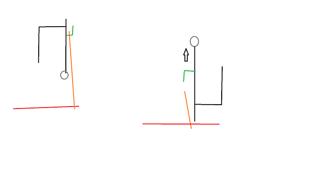

How to get passive this claw to deploy, pls help!!!
Put rubber bands pulling the claw out but then at the start of the match tuck the claw behind part of the lift that’ll move out of the way
Try something along the lines of this, where there is a small lip on the claw and there’s a rubber band zip tied to the drivetrain. When the lift raises, the rubber band will pull the mechanism outwards, eventually making the rubber band fall once the entire mechanism is down. Hopefully this is a clearer illustration of what I mean:
example1
