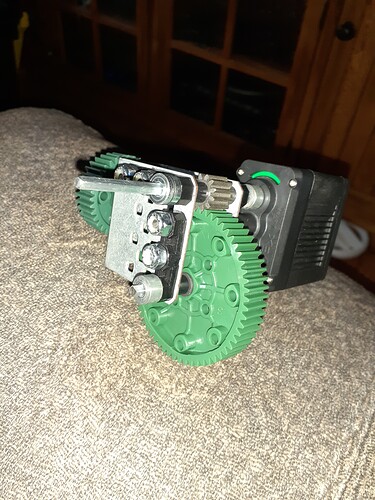

Here is my claw that I am using
Well you see, the whole point of those small gears in the middle is to produce torque. You should move the motor so that it powers one of the small gears rather than the big gear. More torque = more power (for gripping)
To make it rotating, you should attach the claw to something attached to a shaft that is connected to a motor (or gears that create a gear ratio- one of the gears has to be connected to a motor). Some teams use the VEX turntable for this.

You can do what @LilTree said and also replace 3 12T with a single 36T gear. That will have less friction and work better.
