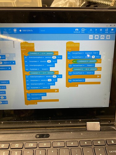

I’m currently using block code, all I need it to do, is when the index/pusher goes back, it stops for a few seconds. this is for driver assisted,
Hi there! Here’s how I coded my limit switch:
(It’s on the far right)
This worked really well for me.
Also that’s including the mechanism it was controlling
You don’t want to have to press the limit switch for it to work, and you would want a control to control the mechanism with.
(That’s a brief explanation)
