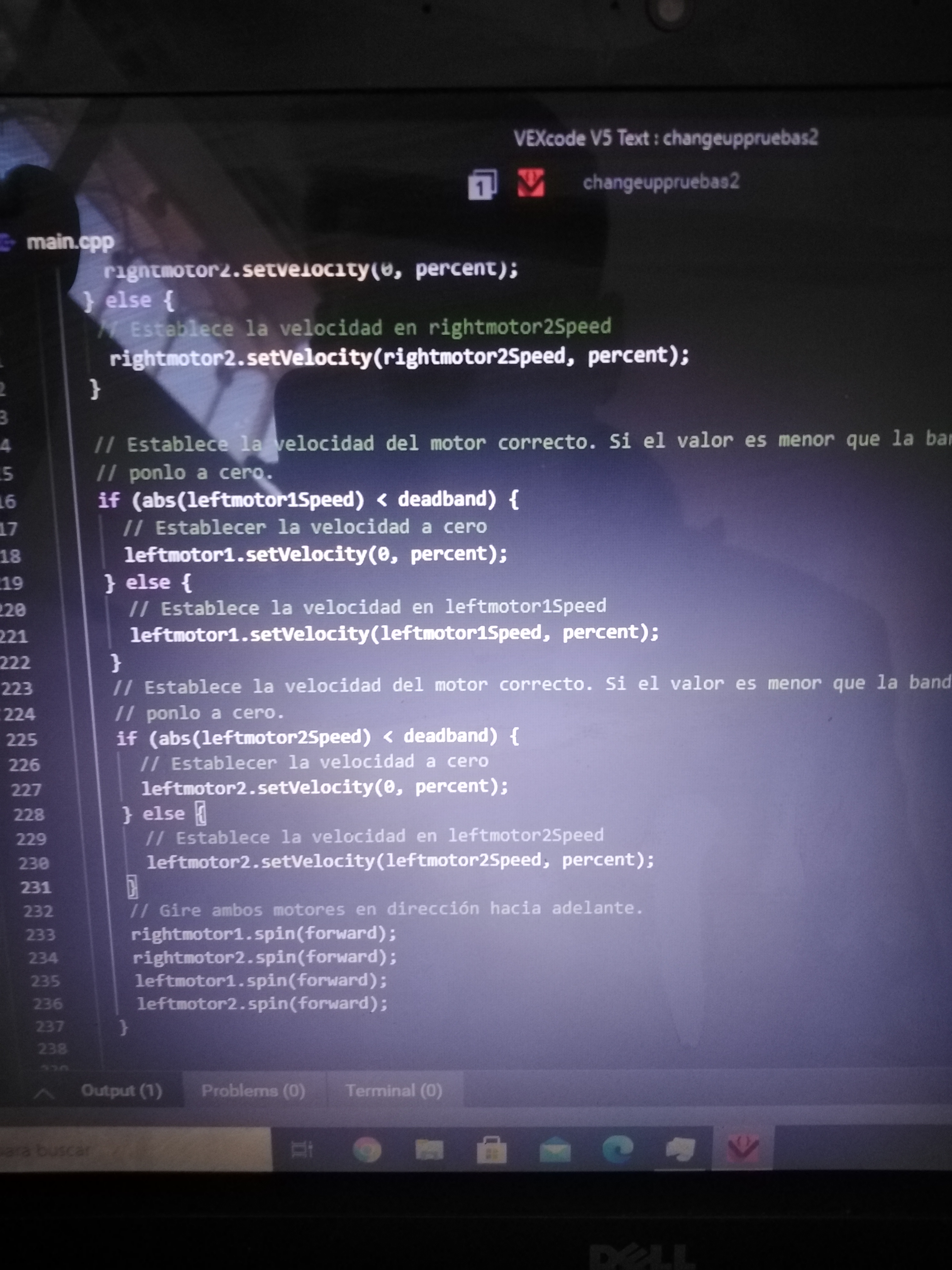

I leave my programming to see if you can help me put specific speeds to the joystick

You would just set the joystick percent on an axis as your velocity. For example:
Motor.spin(fwd, Controller1.Axis3.position(percent), percent);

And as it could be done in my friend programming, I do not want to remove the dead band
Then have the controller1.axis3.position percent equal to the leftmotor speed variable.

If you want to manually enter a speed of 128 (like in the program), then you would just need to set the velocity to 128.

If you wanted to do that, just do something like motor.spim(fwd, 128, percent);
