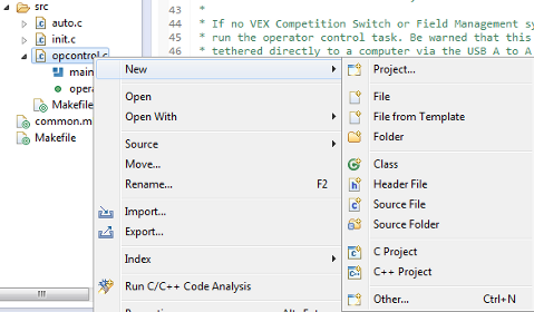

I want to create a function for driving forward
void forward() {
        motorSet( 2,  joystickGetAnalog( 1, 3 ));
        motorSet( 3,  joystickGetAnalog( 1, 3 ));
        //How do I invert the power values for these two motors?
        motorSet( 4,  joystickGetAnalog( 1, 3 ));
        motorSet( 5,  joystickGetAnalog( 1, 3 ));
Where do I place this code? Do I right-click on opcontrol and Create a new File? File from template?
https://vexforum.com/attachment.php?attachmentid=9373&stc=1&d=1432658203
I need to “initialize” the function in the operator control file, correct?
You define/create a function in a source file, it could be in the same file as opcontrol. You call a function when you need to use it.

Functions go in .c files, there is scope to deal with, a function must be written ABOVE code that calls it in the same file to be in scope, or included (also above). You can create a definition (kind of like an index) of a function if you want to declare it under, or later in a file.
