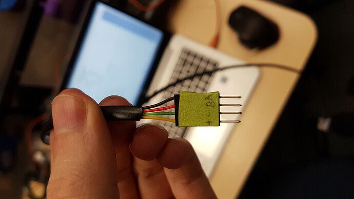

For V5, all the smart ports use RS-485. To communicate with the Arduino, you will need an RS-485 driver such as this one, and will need to connect the A and B pins to the corresponding pins on the V5 cable. The RX and TX pins on the driver will need to connect to corresponding RX and TX for UART on the Arduino. Here is the pinout of the V5 cables by default:

Warning: the power (Vcc) pin on the V5 smart port is the battery output voltage (about 13 V), so you probably don’t want to directly connect that to any electronics; instead, either power the Arduino and RS-485 driver from something else, or use a voltage regulator to step it down.

And another question (may seem that I am silly but I still want to ask) :blush::I can’t find the 4 pins V5 cable :exploding_head: where is it ,can you send me a pictue?
That 4 pin V5 cable was probably made by him, they sell the cable and a kit, but it will not include breakout pins like that.

This is correct, we made our own cable for testing communications between V5 and other microcontrollers, similar to what you are suggesting.
