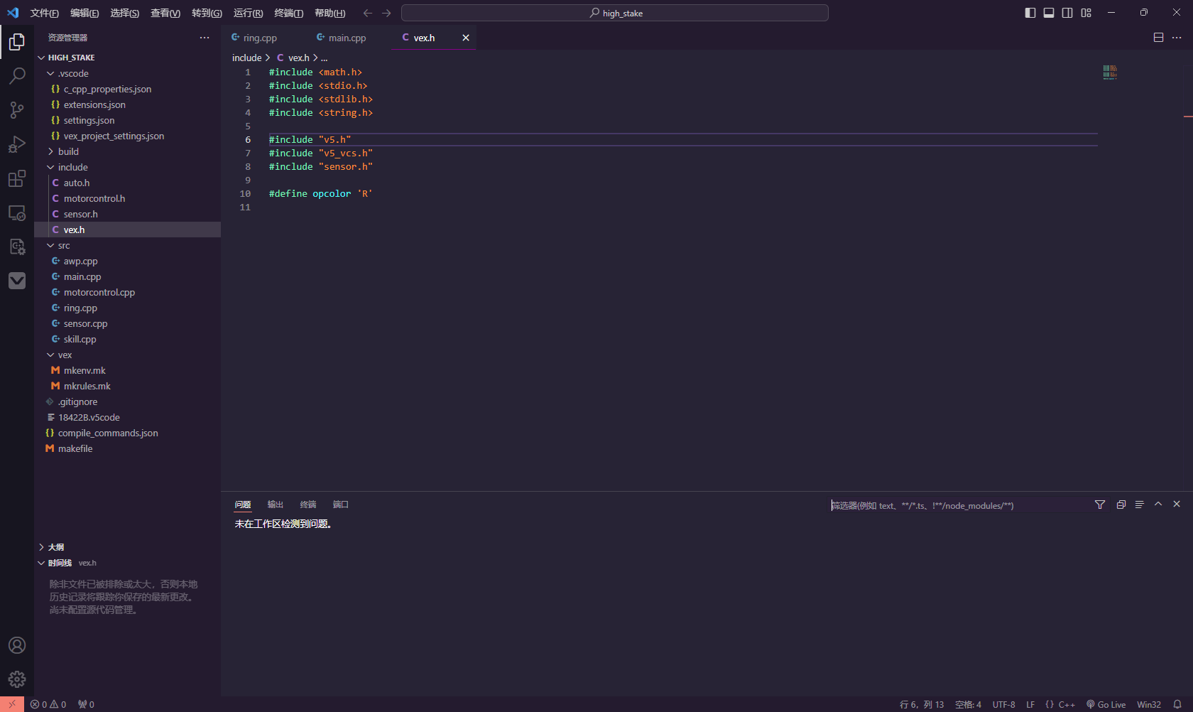

Help,my v5pro in vscode don't have upload button
as you can see,I don’t have the upload button in bottom left

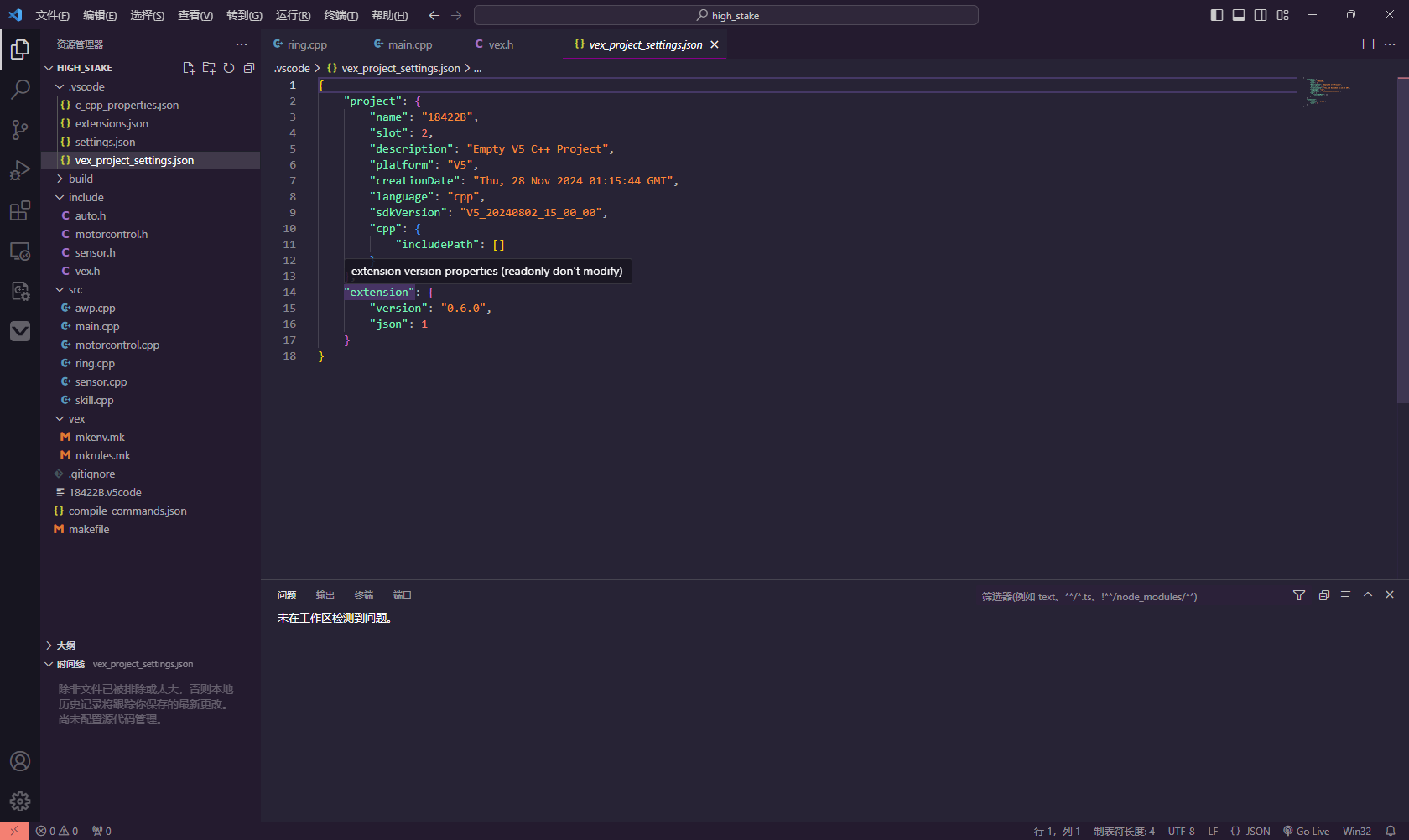

I have the setting json file and the extention of Microsoft C++
I have try to re-download every extend and even vscode,but it’s not work :frowning:

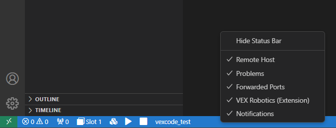

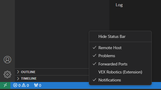

try right-clicking on the status bar at the bottom and then enabling “Vex Robotics (Extension)”
If that doesn’t work you can open the vex menu on the activity bar at the left (it’s the “V” icon) and you should be able to upload from there
ohh,this slove my queston,thank you!!!
