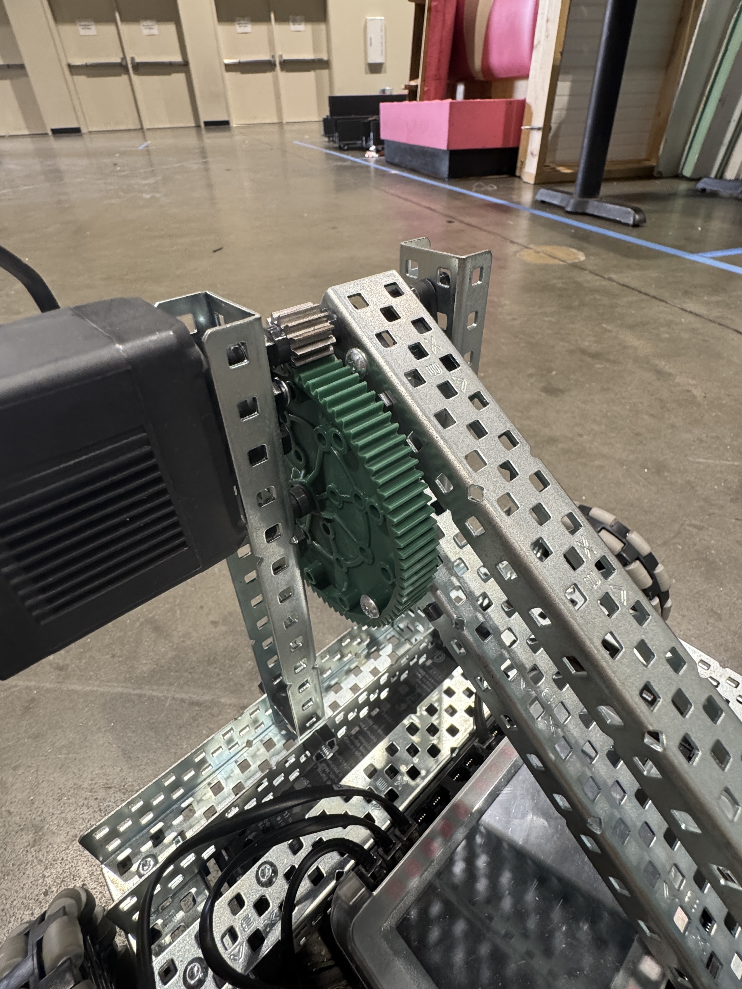

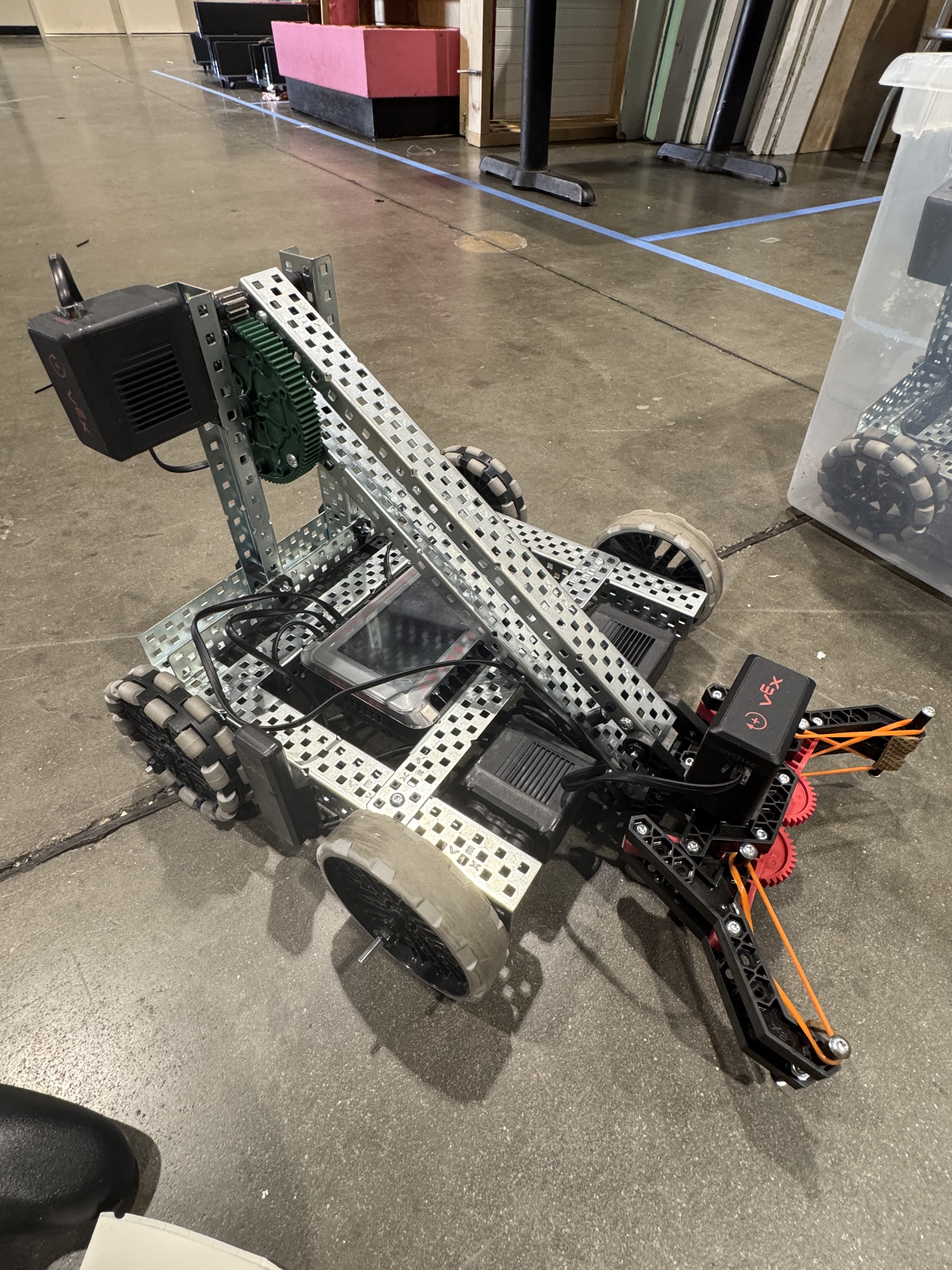

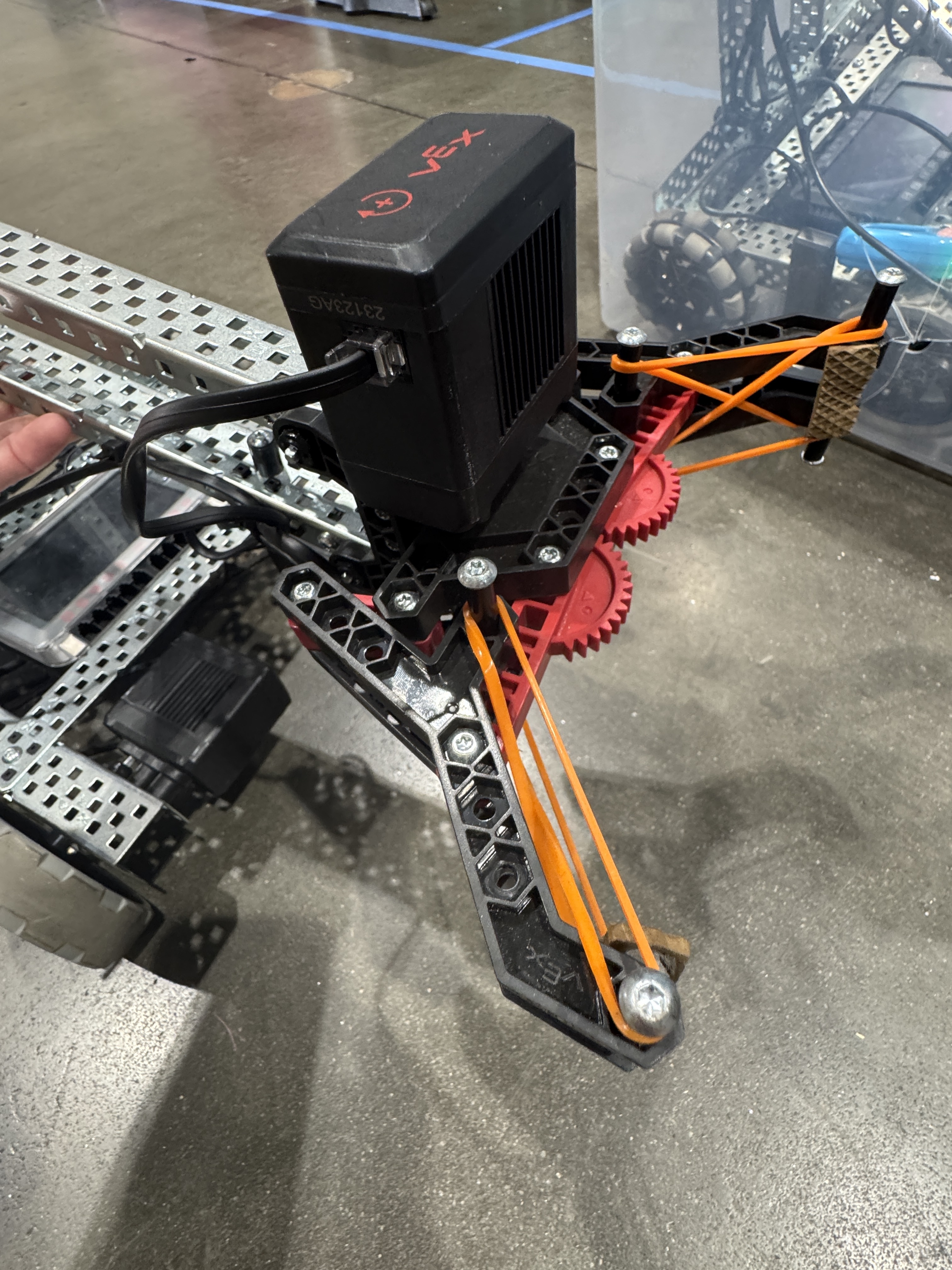

Will you provide some photos of the robot?
My first questions would be:
  • What gear ratio are you using for the arms?
    If the ratio is too low (or not using gears at all), the motors have to work harder to lift and hold the arms, which leads to overheating. Increasing the gear ratio can reduce the strain on the motors.
  • Are the arm motors set to Hold mode?
    In Hold mode, the motors constantly apply power to maintain position, even when stationary. If the arms stay raised for extended periods or under load, this can quickly heat them up.
I did a practice run today with new motors and a new brain and it’s still giving me the overheating signal on port three the claw and Port eight the arm. What can I do to keep the motors from overheating? It’s just a basic claw box build and we’re only running it for a few minutes.
Can you take a picture of the back of the robot showing how the gears and bearing blocks are put together?
