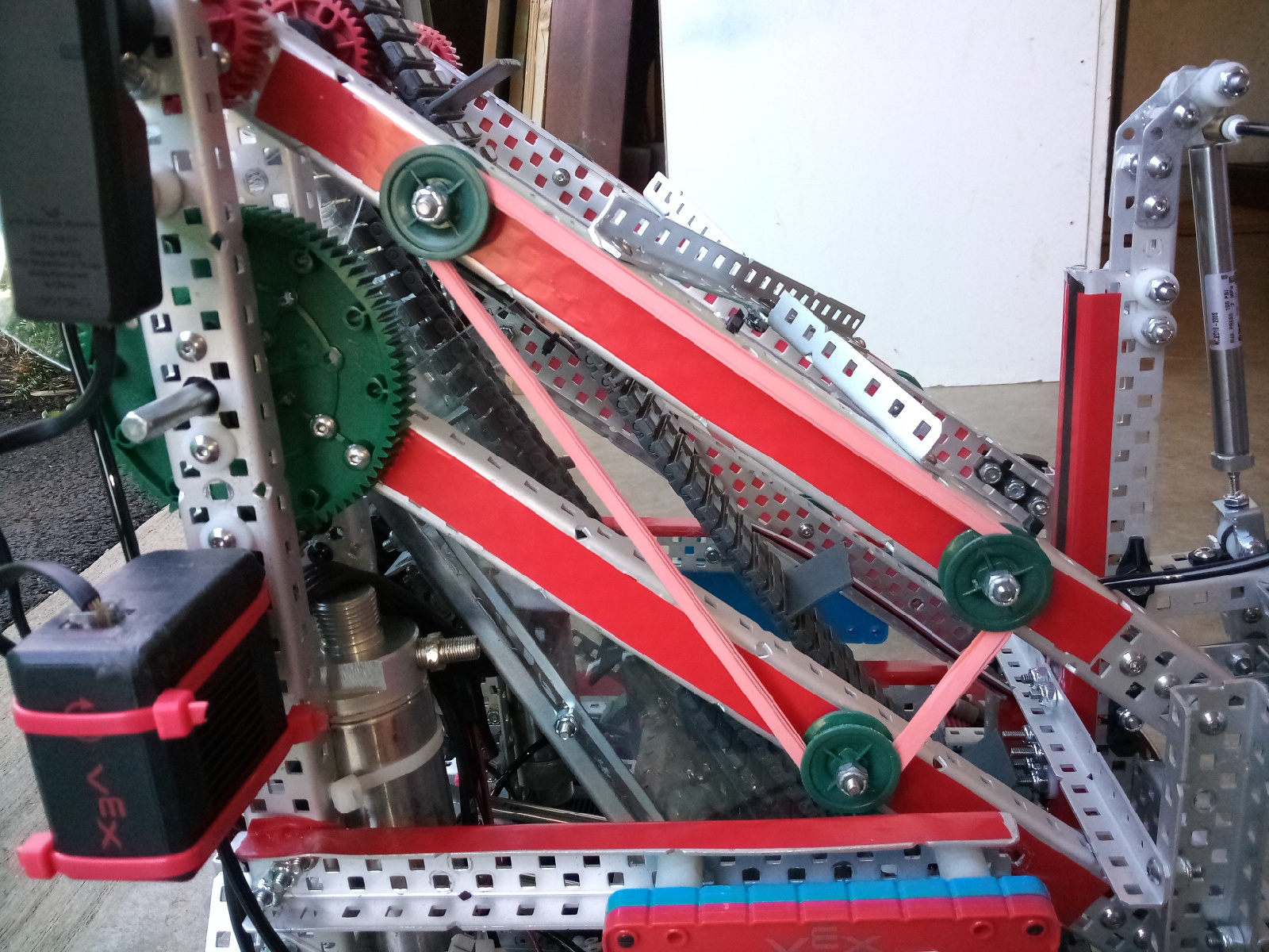

Hi! I am having some trouble with my 4-bar lift. The lift is struggling to lift a mogo any more than a few inches off the ground. The gear ratio is 7:1, which should be enough torque when powered by a 36:1 red motor. The catch is, at and before the state champs, the lift was on a 5:1 ratio and still worked well. Then after states we moved it up to a 7:1 ratio when it started to not work well. At first the change was successful, but when we started doing practice matches and skills runs after states, it would not lift the goals. There is little friction, and it is sturdily built. We thought it might be the motor burned out, so we replaced it…with six different motors, all still not lifting the mogo more than a few inches above the ground. The arms of the lift are all 26-long c-channel. Any suggestions on how to fix it?

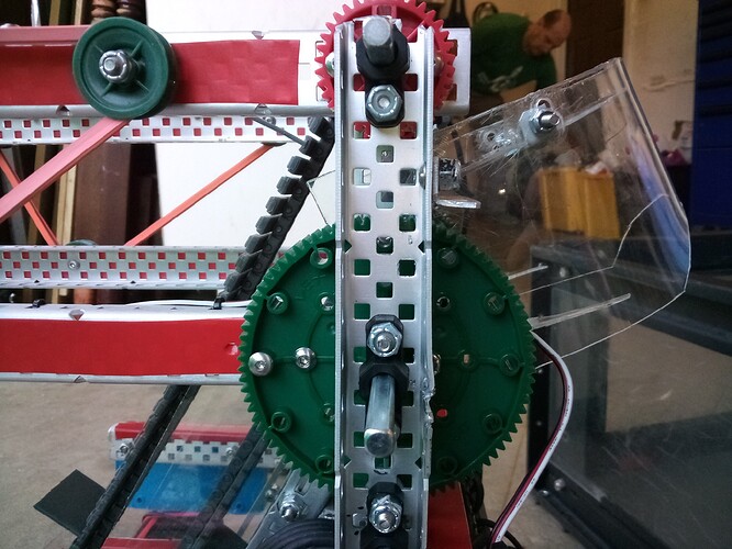

We switched to a higher ratio because we wanted it to be stronger for worlds than it was at states. Also, the lift motor started to burn out several times after we replaced it, so at first we thought it was the lower ratio. here are some photos of the lift:
IMG_20220322_150954|666x500 !
IMG_20220322_151019|666x500
Does it lift a few inches with normal speed and torque and stop, or does it lift slowly and stall out the motor? Also, are you able to complete the full range of motion without the mogo?
From what ive seen (my robot this year had 2 4 bar lifts) the biggest issue could be motor burnout or incorrect spacing. If the arm is able to move without a mogo or if it is able to move when pulled on , then its most likely not spacing, also if you are using 2 motors make sure they are not opposing and are both active. One more thing is my robot did not use any rubber bands (other than for our battery) , and yours might not either.
The lift is powered by one motor. We can lift it without the mogo. The rubber banding helped some, but it still burns out the motor if you use it for more than a few minuets at a time. After we clamp the mogo, it slowly stalls out the motor as we lift it. But only after it is used for like one skills run, under five minuets. Could it be that all our replacement motors are half-dead? We have tried like six different motors and it has happened to all of them. And after we let the motors rest for like 30 minuets, they will work again for five minuets, an so on.

I have a six bar that does this as well. We practice skills runs, and after about 10 minutes the arm will start giving out, and exactly what you are describing happens. This happens with the drive train as well. I have noticed that after consistent use the motors will overheat and stop working. My diagnosis is that there is nothing wrong with your 4-bar, but you are simply using the motor for a prolonged time period until it overheats and its power declines, rendering your 4-bar useless for short period. My advice to you is this:
  1. During competitions and in general, give your bot a break for the motors too cool off and rest.
  2. Cool off the motors using dust-off or some other canned air alternative. Although there aren’t any heatsinks or vents on the motor, this will still help some.
  3. If you don’t have a choice or just rather wouldn’t spend the time waiting for the motors to cool down or “regenerate”, consider swapping motors. If you haven’t already done so, you can modify your mounting system to swap motors more efficiently.
Hope this helps.
Also for the hs axles in the arm, are they connected throughout to fourbar and just on one side. We had problems with lifting and after making the axles connect through the entire arm, we lifted much easier
