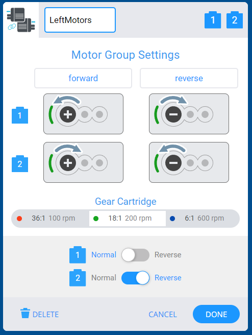

We have a 4 motor drive and we would like to use a drive train, however the 2 motors on each side need to spin in opposite directions (1 needs to be in reverse) and we can’t seem to figure out how to make this work.

Make a motorGroup for each of your left and right motors - reverse individual motors as necessary.

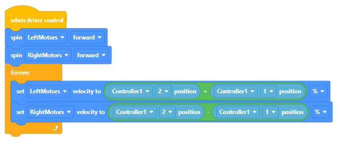

For arcade drive, the velocity is a simple math calculation between the joystick directions.
Thanks for the help. We gave this a try, but this only works with the right joystick while the left did nothing. Additionally, the motors were very slow. Is there a way to fix this?
Hi!
Go underneath the device category (it looks like a battery), and select controller. Keep clicking the joysticks until both are highlighted. You don’t have to use 2 joysticks though…
Also, make sure that you are on your downloaded program and not drive when testing it: otherwise what you did will not be effective
