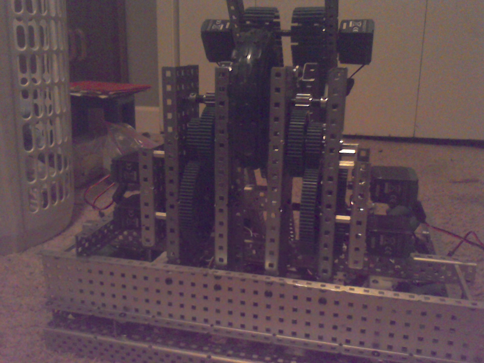

Us in team 2349A have been having serious confusion involving our flywheel. We are currently using a single flywheel connected to an intake similar to team 8059A(refer to their thread) and the robot is not working correctly. We went to our first competition with a working robot and during practice everything went south. It began to slow to a stop after about 3 balls shot. It never had this problem before and even after days of cooling it will not return. We have tried changing all the motors, changing the gear ratio, changing the brain, changing the motor controllers, and rebuilding the gear ratio. Nothing seems to be working. I don’t know what else to do. Looking for suggestions. Thinking of doing it with a smaller gear ratio, but with 6 turbo motors running at 80% instead of 4 high strength motors at 100%. Appreciate any help

We are currently using a 5 inch wheel and the gear ratio as shown in the picture. I have tried removing the motors and spinning it and it seems to move freely with no friction. Hope this picture helps.
That looks like a 3:105 (Flywheel > 1:5 > 3:7 > 1:3 > Motors) (at least, it looks like the motors have a 36-tooth to 12-tooth).
I think that might be a bit too high for four motors, so as a quick test, I would take out the 12-tooth from the 1:3 ratio and just move the motors down (or up) two/three holes for a ratio of 3:35 (Flywheel > 1:5 > 3:7 > Motors). Although that would be a bit too slow for full court, you could easily change to turbo (keep four motors) or just change the ratio to something higher (2500~3500 RPM).

Well I just redid everything and put it back together and it runs really smooth with my hand but without even a ball going through it, the motors quit out. The internal gearing is now turbo. But it is at 100%. I don’t have the programming laptop with me atm. But will lower this once I get to school. I’m going to lower the gear ratio and post results.
Yeah, that gearing is almost double it should be. You might just try using normal HT motors (100rpm).

We made the same mistake as you. It’s really hard to tell in 8059A’s picture, but there is no 12t pinion gear between the two 36t gears on the motors. The motors are geared together with 36t gears, and then the shaft from one of them continues through to the 84t gear.
It should be a relatively easy fix to move the motor up and reduce the gear ratio, and then it’ll work great!
Oh wow. Well I didn’t know that. Thank you for the input. I will try to change that. I have been wondering how they were able to turn the gears with a turbo motor. And with the pictures that I saw I didn’t know whether or not they used one.
