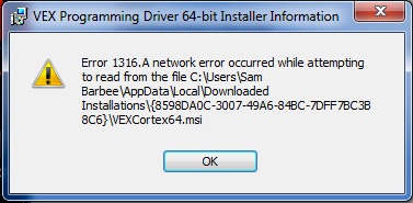

So I disabled verification for signing and re-installed the “Usb-to-Serial”
Still no success.
So I went to install the other driver listed on the homepage “Vex Programming Driver” and I got an odd error. I screen shoted it and attached it.
I’m using the old programing kit.
The old programming kit uses the prolific driver, there are some known issues, see this thread and perhaps check the driver version against this list and report back to us.

Thanks for the help. I have it up and running now. :smiley:
